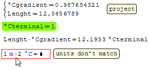

Hello everyone!
I found some strange behaviour. Let's assume two dimensionless quantity length:=10 and temp:=12. Now I multiply length * 1m and the result is 10m. However if I multiply temp * 1degC the result is error because temp is not defined? Is it some kind of a bug?
https://ibb.co/B2203KY

124 likes in 298 posts.
Hello everyone!
I checked and it's really strange

why you type an additional "'" between temp and °C ?
It is enough to type: temp*'°C=

#9 Posted: 9/16/2021 2:39:43 PM
Porschaka
Porschaka
2 likes in 5 posts.
It looks like a bug to me. Is there a chance that it will be fixed any time soon? What do you think? Will use "'" between temp and °C for now...

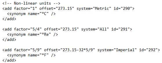

Very strange, seems to be °C, °F, and °Re.
Interestedly enough, these are the units labeled in the units.xml file as nonlinear. I don't know what any of this means, but I'm sure it has something to do with the built in functions that get us these three units.

Keep in mind that if you define a new dummy unit for °C by adding a "'" to the front, you don't solve your problem.
The conversion for these 3 units is not linear, meaning you can't just multiply by a factor to get the conversion.
If you are only planning on working with your own isolated units without taking advantage of the built in units, then go right ahead and define a custom version of the unit.
This issue needs to be solved in the programing or with a custom function that does the conversion for you the right way and can handle the nonlinear units.
