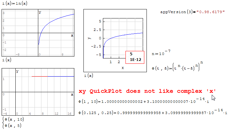

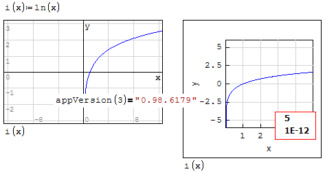

#4 Posted: 10/4/2018 10:55:54 AM
983 likes in 6866 posts.
When I try to type i(t) I get i*(t), automaticaly. Why?
Basile
The problem is within version(s) past 6179.
#5 Posted: 10/4/2018 11:38:31 AM
1403 likes in 1708 posts.
This is a feature of the program, not a plugin.
#6 Posted: 10/4/2018 9:44:46 PM
Basile,
Can you plot or not ? That is the question.
If NOT: a damned bug or missing link.
Certainly not a feature. That 'i' imaginary freaks an indexed
for loop still exists in 6179 ... index 'ii' or else.

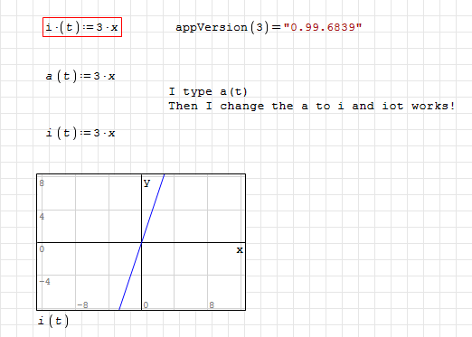

#7 Posted: 10/27/2018 10:48:14 PM
Basile
Basile
8 likes in 172 posts.
Hello to All,
This is my solution:
Basile
