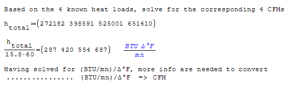

Before applying some suite, you must have something to process.
With only two temp. BTU means nothing. Two values are missing.
With the two you provide: who knows to what BTU rate they apply ?

#4 Posted: 4/18/2016 5:22:30 PM
983 likes in 6866 posts.
Maybe like this ?

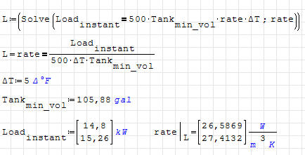

solve%20block%202.sm (4 KiB) downloaded 81 time(s).

mkraska - Thank you, but not what I was looking for. I have the power already calculated/known ... I am looking to solve for a rate of time. As you can see in my example, the program will solve as long as I do NOT define the solve block with a variable. It also looks like you are using the Maple plugin.
Update, I thought that Vectorize eliminated the nesting issue. I think that is what is going on as my solution may be a nested item and not a matrix. Definitely a nesting issue. How do I "un-nest" a Vectorized equation? Solve Block 2.smz (2 KiB) downloaded 80 time(s).without jMG Matrix manipulation. I was hoping Vectorize would simplify the issue.

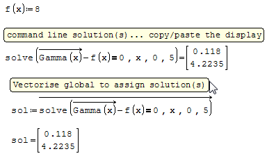

The solve block is not compatible for assigning objects that are vectorized.
This was first noticed solving Gamma(x), that solves un-assigned.
erf(x), Gamma(x) are two reported, that solve from vectorising, not assignable.
Nothing to do => copy/pate ... Does not spool to file either

Maybe, I don't understand the question. To me, it looks like you try to repeatedly solve an equation for various values of the constants in the equation. And you have vectors of these constants.
So what I did was to generate a symbolic solution and use vectorize to apply the various input values. But you didn't seem to like it.
Also, I am a bit helpless faced with your use of units. I'd use units only in values of quantities, never as free parts of equations, otherwise these equations become dependent on the units used. My approach shown above is completely consistent in terms of units.

Any recommendations?For now, I will do copy and paste, but I would like to "automate" the solution since these numbers are used downstream.I'm not seeing a programmed solve program, unless there is an example I missed in the forum.
You have missed nothing from the forum, has never bee exemplified.
I don't work with units, sorry for your work sheet.
As explained before => Gamma(x) is one that needs be vectorised locally
That does not exclude global vectorising for further use, downstream the document.
