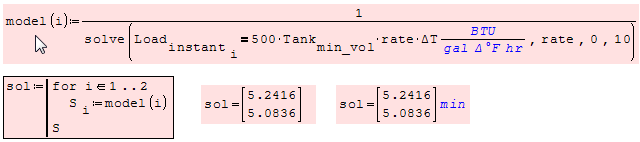

wondering why I cannot do it with vectorize
The solve block solves for intersection of functions
Though the way you vectorise gets a display, it does not construct a kernel.
You can solve unlimited system, from a simple loop constructed from a model,
then address a particular part or a selection of solutions.
Solve Block 2a [Like This].sm (20 KiB) downloaded 75 time(s).

I was afraid I would have to resort to the loop structure
Funny, as engineers, they don't understand the programming, but they will take an excel sheet no problem ...
Elsid,
I can invent a much longer model and show how to recover
the respective part(s) of the project. It's much better
you give your stuff ... I will complete the "for loop list"
