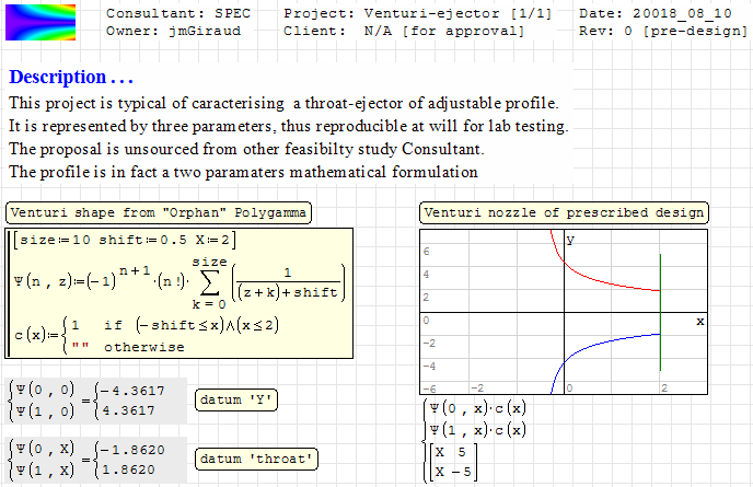

WroteThanks.Interesting how you've combined a background image
Do you really know what you want ?
Such a big horrible logo at the top of each page as you ask before ?
Or my suggestion from a saved *.sm that you open and immediately
copy/paste in blank sheet, close the original and go for the project ?
BTW: you don't have to save the logo image as whatever [*.PNG, *.BMP]
you capture, the word is capture from the screen and paste in Smath
work sheet. My preferred capture tool is WinGrab [freeware].
Did you open my attachment Smath document ?
Did the PDF opens ?

#23 Posted: 8/10/2018 9:33:39 AM
WroteHowever, the downside is that it is a manual operation for each page ..
Good thing is it a personalized construction. If I would be your client, I would reject
having that stuff at top of each page, breaking the visual suite of project calculations
that span more than one sheet.
The footer is universal at bottom n/N
The header is by default:
1. Universal local time at the machine
2. Document identification
Header & Footer appear on the printed document, no need to have that crowd
the project work sheet. As your client, would reject that as well.
Add extra in the Header: &[DATE] &[TIME] - &[FILENAME] - [Rev_1: Geoff]
As plain as possible, text white background [254,254,254]
Once your company logo has been capture and pasted,
it is resident in the Smath work sheet, i.e: the saved Cartouche template.
Assume your are the Grand Savant of something, I'm your client.
For sure, if your maths are too much for me, I will have the design proofed
by some independent competence that will surely dislike the Cartouche at
the top of each page, particularly if I give him a PDF.
All those are just comments. Cheers ... Jean
