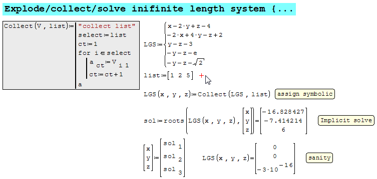

1. Solving Algebraic and NON-Algebraic are two different animals.
2. Be very careful from so much from so little
3. Collect/solve at will from algo.
Can't do more w/o work sheet ... does it help ?
Solve Algebraic, NON-Algebraic Read first.sm (60 KiB) downloaded 48 time(s).

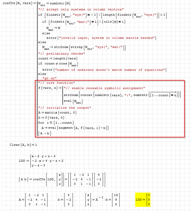

Here you have a generic function; the second one uses Unknowns from Custom Functions plugin, while the first requires you input the unknowns as second argument. Anything above the "core function" comment is just input checking, not strictly needed.
coeffs.sm (30 KiB) downloaded 50 time(s).
As for the error message, don't put that line procedure in the system or change it to return a result (the result is taken from the last argument/placeholder in the line function, in your case there is a loop in that placeholder, that is why the program doesn't understand what should be the value to assign in the system).

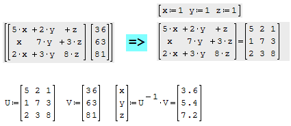

#5 Posted: 4/11/2020 2:00:14 PM
WroteHow, to write the coefficients of LGS in a matrix ?
That should do ... do more at the end of *.sm attached
Solve Algebraic, NON-Algebraic Read first.sm (70 KiB) downloaded 52 time(s).

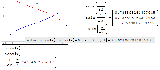

BTW.
Symbolic eval acos(1/sqrt(2)) = pi/4 but -asin(1/sqrt(2))=asin(1/sqrt(2))
ist this a bug?

#7 Posted: 4/11/2020 4:18:39 PM
WroteIn my experience it is easier to write down the equations than to work with the matrix input - especially when revising, deleting or adding.
You have first shown solving, thus helped accordingly.
You can add/delete/collect shuffle unlimited from "list"
and not solve as you demand ... try it list:=[5,2,3,4,1]
No simpler method may exist than this algo style ... 1/1 Mathcad.
Page2 Shuffle Solve.sm (14 KiB) downloaded 48 time(s).
