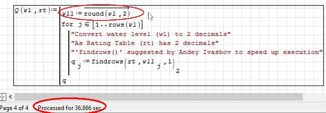

#1 Posted: 2/24/2018 4:28:28 AM
Examples compare speed of execution using Vectorize Operator vs Array Index in Large Matrix Analysis.

#2 Posted: 2/24/2018 6:44:14 PM
Hi. This is the help page for matlab about what their call (in matlab slang) the "vectorization process", instead of the use of "scalar approach" which include for and while loops: https://la.mathworks.com/help/matlab/matlab_prog/vectorization.html
So, scalar = for, while, slow, and vectorial = vectorize in smath, and fast.

#3 Posted: 2/24/2018 11:01:55 PM
Hi Razonar
Thank you for the useful info.
#4 Posted: 2/25/2018 12:45:47 AM
WroteExamples compare speed of execution using Vectorize Operator vs Array Index in Large Matrix Analysis.
Here attached a good demo.
VectorizTest.sm (22 KiB) downloaded 102 time(s).
#5 Posted: 2/25/2018 7:28:27 AM
Thank you Jean!
