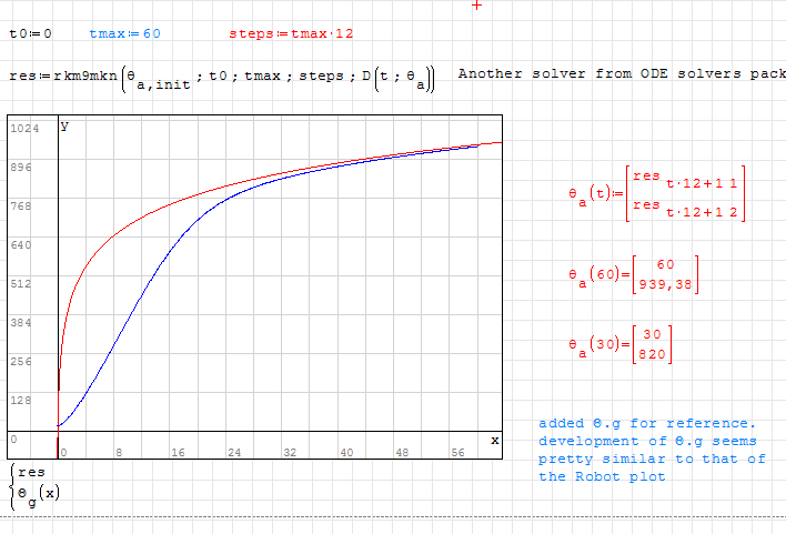

The plots are finally starting to resemble that of Robot!
I have made pointed out the one variable I am uncertain of in the bottom of this file.
It seems the time is still in minutes, but is the temperature in Celsius?
Is there a way to return the temperature after t minutes? In the snapshot from Robot you can see Oa,max=940,96°C after treg=60,00min.
Ultimately, the goal is to have the equation return the temperature after a given time θ.a(t).

I think I found a solution to return the temperature after a given time.
There might be better solutions for this though?
#11 Posted: 10/26/2017 5:14:39 AM
325 likes in 2052 posts.
As you have points from the solution you could make a function from them by spline interpolation (for example).
See the attached file. By the way, you do not need to many steps for these ode solvers.
4.2.5Steeltemperaturedevelopment-reply-3-corr.sm (89 KiB) downloaded 83 time(s).

Thank you very much for your help. You have helped me solve my initial problem (problem 1). I really appreciate it.
1. What at the streghts/weaknesses of the different solvers? why go for one or the other? Is it correct that this DE is stiff?
2. What difference does it make if I have 1 step/minute (Δt=60sec) or 12 steps/minute (Δt=5 sec, which is the highest allowed Δt according to EN 1993-1-2)?
3. What is the difference between ainterp() for returning temperature at a given time, and my approach in my previous post?
If you could please help me understand if it is possible to solve my second problem in Smath (problem 2 ref. my initial post).
Many thanks
There are stiff and non-stif ode. There are also many numerical algorithms for ode (SMath have lots of them) and therefore many solvers. It is all right to try few of them (fortunately SMath has lots of them) .
Quote
I think you missed the point. The steps in the solver gives you the result at the distinct equidistant points and it does not have to much connection with your mentioned rules for Δt.
Quote
ainterp() will give you the function (was that you were looking for) and your approach will give you the points. For instance, how would you get the result for, say, after 12.3462 min by using your approach?

2. OK, I think I understand. The fourth argument in the solver only affects how the result is presented, but it does not affect the calculation. Do you know what the steps in the calculation is?
3. θ.a(t):=res,t*12+1,2 seems to work just like θ.a(t):=ainterp(time,O,t), or am I missing something?
