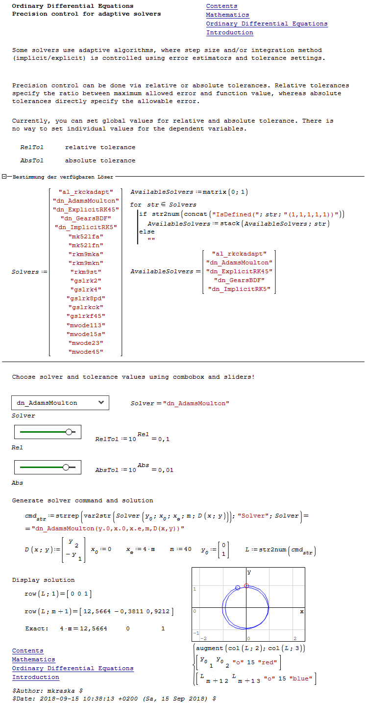

After recently learing how to write for loops, this forgotten project popped back up in my mind again..
My newfound knowledge got me quite a bit further, to the point where i think this project is complete as well.
Just one question - is it possible to define a function quickswitchODEsolver(a,b,c,d,e)=ODEsolver(a,b,c,d,e) <-- This could be Rkadapt() for example, or maybe another solver.
Can the 8 different resolutions then be solved by quickswitchODEsolver()?
The goal is to have to change the solver function only one place rathere than 8, if I want to switch.
Cheers.
Temperaturforlop.sm (119 KiB) downloaded 58 time(s).
sergio 10/31/2020 7:53:00 AM
#84 Posted: 10/30/2020 9:37:36 PM
1402 likes in 1708 posts.
Try this https://en.smath.com/forum/yaf_postsm51257_DotNumerics.aspx#post51257

#89 Posted: 10/31/2020 9:38:52 PM
1222 likes in 2150 posts.
Cheers.
There might be smoother ways but this works. Note that I had to replace the sliders because the old regions don't seem to work any more with new SMath versions.
Section Math ODE precision.sm (23 KiB) downloaded 54 time(s).

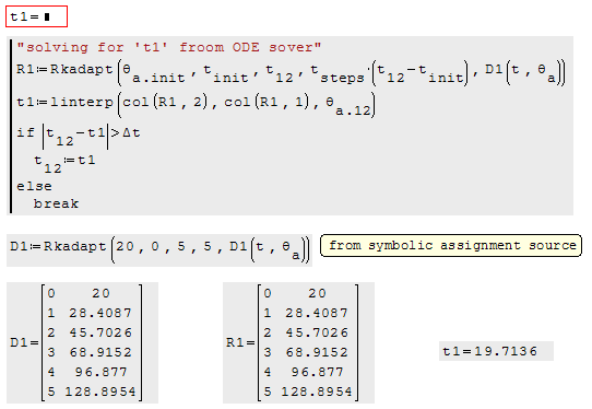

#90 Posted: 11/1/2020 5:44:28 AM
hanskl
hanskl
7 likes in 158 posts.
Thanks. I already had a go at this approach as uni directed me towards it.
It works fine when I apply it to ODE itself, but when I wrap the ODE into a for loop (a necessity to establish boundary conditions for the whole set of ODEs) something goes wrong..
Cheers
#91 Posted: 11/1/2020 7:19:24 AM
hanskl
hanskl
Few comments:
1. As soon as you can plot something, plot ... this is a must.
2. RK solvers are known to over-shoot [Mathematica, Mathcad/Mathsoft ]
3. The Simpson "Premise" is all correct in there.
4. Use solve(,,,,) instead of your other junction.
5. Red top to bottom in SS 6179
Thanks for putting me on a different track.
Solve() also serves the purpose of finding the boundary conditions for DE2-4, although I guess the way I have set it up (might be other ways) does make the ODEs compute a lot of unecessary results (they all go all the way up to t.final, but they only have to go up to t.lim - hence the for loop).
This way the mkraska method of switching solvers work, and it is quite interessting to see the discrepancy in computational times. dn_AdamsMoulton takes way longer to compute, and actually runs into trouble when the tolerances are high..
Any ideas on a setup that stops the DE's when they reach t.lim rather than t.final while still being able to choose the solver?
Cheers.
Temperaturforlop_test_2.sm (92 KiB) downloaded 51 time(s).

#93 Posted: 11/1/2020 11:47:24 AM
983 likes in 6866 posts.
1. The for loop not needed
2. something goes wrong argument must be scalar
't' is not a free running scalar in your for loop.
