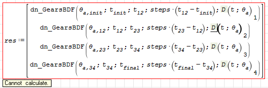

Jean,
I must be missing something.. I tried to downgrade to suite 6671, and dn_GearsBDF still tells me it cannot calculate.
I don't understand why the DE cant handle e^ø. Or have I constructed the DE wrong?

#71 Posted: 5/7/2018 10:22:45 AM
983 likes in 6866 posts.
Jean,
The books style are very difficult to put it executable.
Your DE setup looks quite correct: proof the first one works
but the 2, 3, 4 "Division by 0". It must have to do with the
meshing of the Solver. It does not like something in there.
Should work in your latest 6671.
I simply reconstructed piece wise, simplified, on my 6179.
See U tonight ... Jean

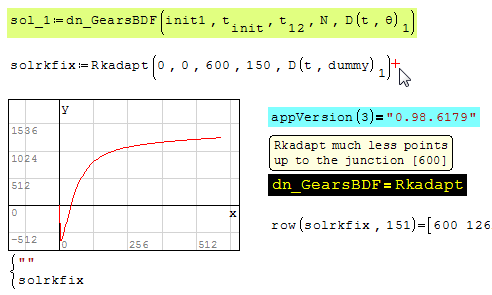

#73 Posted: 5/8/2018 12:47:40 AM
Jean,
I can not get it to work in my current version of Smath.
Is it possible another solver has to be used? One of the Runge-Kutta versions maybe?
You are quite right though, the fact that the first of the four equations work on your sheet suggests that it should work. However, that values in the solution you posted is quite wrong... Not quite sure why that is though, has to be something with the input.
I'm quite curious as to what the workaround/solution to this project will be. Looking forward to seeing what you will come up with
Hanski,
A bit of headache
Those solver may fails ... guess the cause "Division by zero".
You should have the first segment running as the picture.
Just to show how difficult it could be, read the ODE Yuk.
Temperaturforlop Compactum.sm (60 KiB) downloaded 60 time(s).

#76 Posted: 5/8/2018 8:12:25 AM
... Oh ! it didn't upload.
17 solvers, only rkfixed responds at very specific 'N'
ODE Yuk.sm (27 KiB) downloaded 60 time(s).

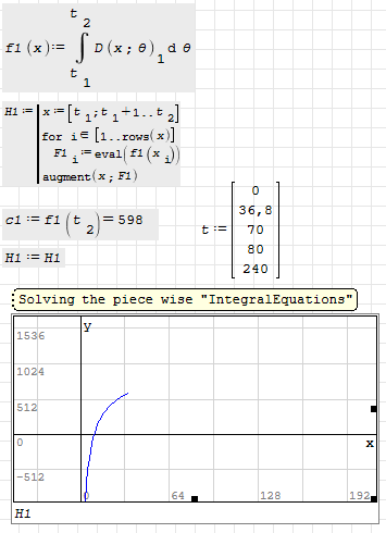

#77 Posted: 5/8/2018 10:44:00 PM
Is Mathcad able to handle this DE? Can anyone try to solve it there?
I doubt because rkfixed, Rkadapt are same.
The first segment maybe ? from the "Stiff option"
Good news is that the project has an elegant solution.
It consists in solving the Integral Equation
Will post it before bed time ...
#78 Posted: 5/9/2018 12:03:51 AM
... maybe there is some applicable scaling factor ? ?
Temperaturforlop Compactum Copy.sm (48 KiB) downloaded 52 time(s).

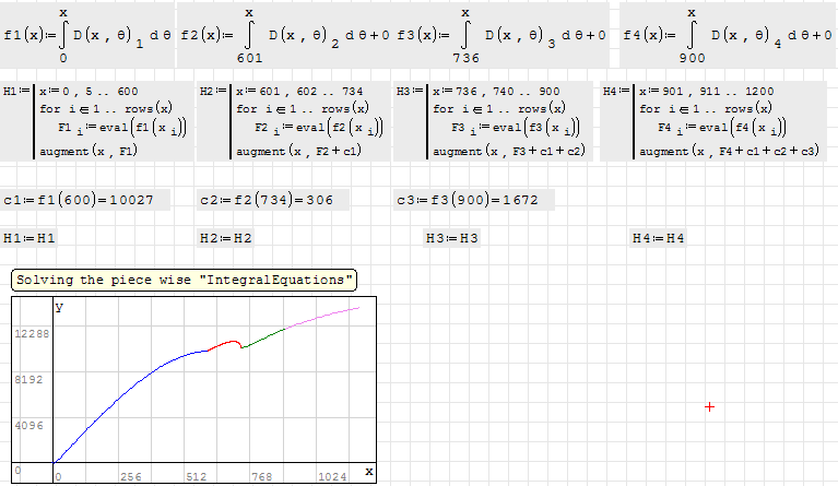

#79 Posted: 5/9/2018 4:31:13 AM
hanskl
hanskl
7 likes in 158 posts.
Interesting! I will look into this later this evening!
But from the top of my head - the X-axis should represent time in minutes, not temperature.
Also, it took quite some time for the sheet to finish calculating.
Best regards,
Hans Kristian
#80 Posted: 5/9/2018 10:55:01 AM
Best regards,
Hans Kristian
1. You can leave it in native 't'
2. the default Integration accuracy is 100, set it 50
it will have no influence in this application but much faster.
1.7 min in my 1.66 GHz laptop runs 225 greedy maths.
3. Does your version bracket t:=[0,5..600] ?
rather than Smath 6179 t:=0,5..600
Temperaturforlop Compactum Copy.sm (53 KiB) downloaded 57 time(s).
