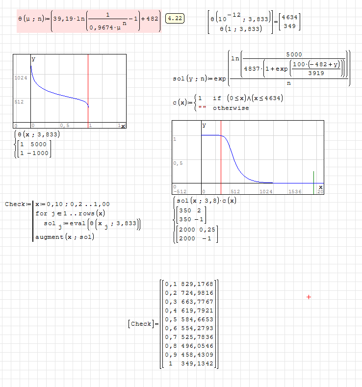

#21 Posted: 10/26/2017 2:43:56 PM
983 likes in 6866 posts.
It is simply a matter of symbolically reversing a equation with respect to a variable.
Part of the answer in red [attached]
Will be back later on. Inversing a function
is sometimes difficult, but always possible.
Cheers, Jean4.2.5 Steel temperature development.sm (25 KiB) downloaded 75 time(s).

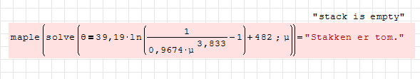

#23 Posted: 10/26/2017 2:50:46 PM
hanskl
hanskl
7 likes in 158 posts.
Thank you for helping me.
I just added the Maple plugin. It now tells me the input format is not valid...
#24 Posted: 10/26/2017 3:40:37 PM
... solving for muo is almost constant, still puzzling ?
Will be back tonight.
4.2.5 Steel temperature development.sm (34 KiB) downloaded 57 time(s).

#26 Posted: 10/26/2017 6:25:00 PM
This is the result I get.. I don't understand..
Ah ! Your attempt is incorrect, why ?
Power function X^Y is devil to maths. It involves ln(x) & exp(x),
Thus too reflexive for any symbolic solver, you must generalize.
See attached all, correct now.
Cheers, Jean
4.2.5 Steel temperature development.sm (41 KiB) downloaded 63 time(s).

#28 Posted: 10/26/2017 6:52:22 PM
hanskl
hanskl
Cheers, Jean
I'm sorry, but I really don't understand your approach to solving the equation 4.22 for my.0. But the results in the Check-matrix are indeed correct. Can you please explain what you did there?
Thanks

#30 Posted: 10/26/2017 11:23:15 PM
By inspection, if μ is < 1, we know in advance the result will be complex.
The "check" was to confirm this assumption. When you say solve for μ,
you are correct in your own words. In fact the matter is to inverse the roles.
From the explicit f(x):= ... where 'x' is given on range, now you want the
inverse of the procedure, i.e: given f(x) solve for 'x'. The procedure is
called "inversing". The Maple solution is the InverseFunction.
On that, Smath/Maple companions are far superior to Mathcad 11/Maple.
Please, read more on the revisited work sheet.
I will look at Radovan.
Cheers, Jean
4.2.5 Steel temperature development.sm (38 KiB) downloaded 63 time(s).

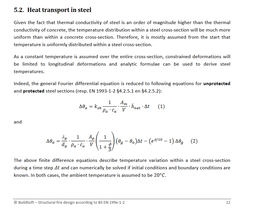

#36 Posted: 10/27/2017 5:56:24 AM
hanskl
hanskl
Try this one with another solver - dn_GearsBDF (it will escape from the critical regions - possible division by zero). Actually, it will work for all the four c.a() but not if you put them in the condition statement.
425specificheat-2-corr.sm (738 KiB) downloaded 61 time(s).
Hi Radovan,
Forgive me my ignorance, but it still seems to me your result does not consider c.a as θ.a develops.
Is this completely impossible using SMath?
Best,
Your differential equation is dθ.a/dt = D(t,θ.a) = f(t,θ.a,c(θ.a)). Your goal is to find θ.a(t) by solving this initial problem in the range t[0,150] provided the initial condition θ.a(0)=20 finding θ.a(0+..150). I do not know how else to explain this to you, sorry.
P.S. The main problem here IMHO is why the solvers can not accept conditional statements for c(θ.a) taking into account the numerical nature of the solving this problem but, on the other hand, the individual c(θ.a) causes no problem.
I understand this part I think. It makes sense
What I don't understand is whether or not SMath is able to solve this. If it is able to do so, how do you formulate/structure the equation/solution?
If SMath is not able to solve this, what other approaches is viable to solve this problem?
I am sure this is a rather common problem in the world of chemistry and chemical engineering?
Best regards,
Edit: found a pdf which have tabulated θ.a(t) for different values of k.sh*A.m/V (=0.9V/A.m,b)
Page 7-10
tables for theta.a
Edit2: found another pdf which discusses the differential equation. It is apparently a Fourier equation, if that helps matters any.
Page 12-16
Fourier equation
