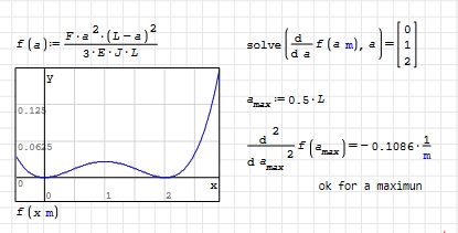

#2 Posted: 7/1/2021 2:22:14 PM
Alvaro Diaz Falconi
Alvaro Diaz Falconi
997 likes in 1676 posts.
Hi. This?
Beam max deflection.sm (38 KiB) downloaded 79 time(s).

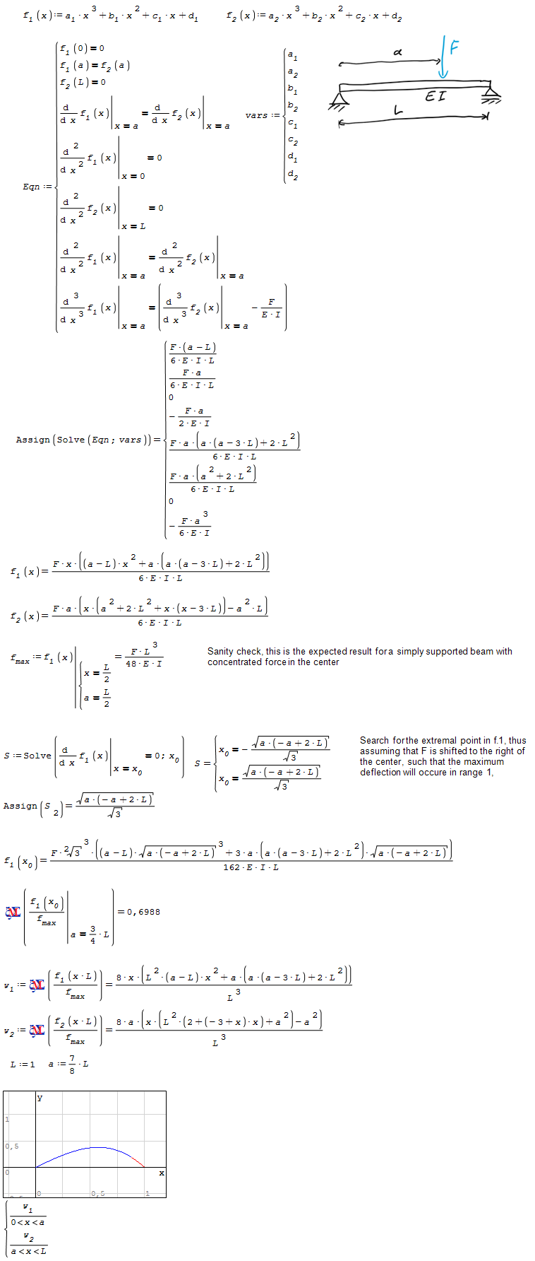

EngMath 7/1/2021 4:57:00 PM

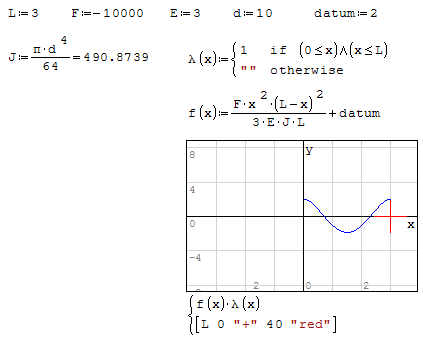

#6 Posted: 7/1/2021 4:55:31 PM
555 likes in 1333 posts.
Thank you very much. I just wonder why the plot has a concave part in the middle instead of being a regular parabola.
Function has to to plot only between 0-L.
You have to limit otherwise it will try to plot for all numbers.
In case you don't limit, that will create the plot which Razonar provided.
Which is not wrong but over-plotted. No need to plot outside of 0-L.
You need to plot with units eliminated of course.
Since F is considered positive directioned, f(x) shall be plot as concave.
To plot as convex, try to reverse direction of F by multiplying it with -1.
Or simply reverse the f(x) by multiplying it with -1.

#8 Posted: 7/1/2021 5:15:23 PM
Let's say that we don't know that deflection will be maximum with force acting in the middle of the beam. How can I find the maximum deflection in SMath?
By the way, if we return to your original question;
Maximum or minimum peak point of a function is differentiate of that function.
You can find it with solvers like solve(), roots() or FindRoot().
First plot the function as it is, it will give you an idea for its maximum or minimum.
Just choose a fine starting guess for solvers, they will deal the rest.
Maximum deflection shall be the result of function by using the length which solvers found.
EngMath 7/1/2021 6:30:00 PM

#10 Posted: 7/1/2021 6:14:29 PM
1230 likes in 2155 posts.
Here is a solution for the elastic line of a simply supported beam from scratch.
I don't know what the formula in the topic opening post is meant to be.
Worksheet6.sm (47 KiB) downloaded 78 time(s).

#14 Posted: 7/2/2021 9:48:15 AM
983 likes in 6866 posts.
1. This document implements Martin formula.
2. From there => location of max deflection and value.
Is that what you were looking for ? ... Jean
