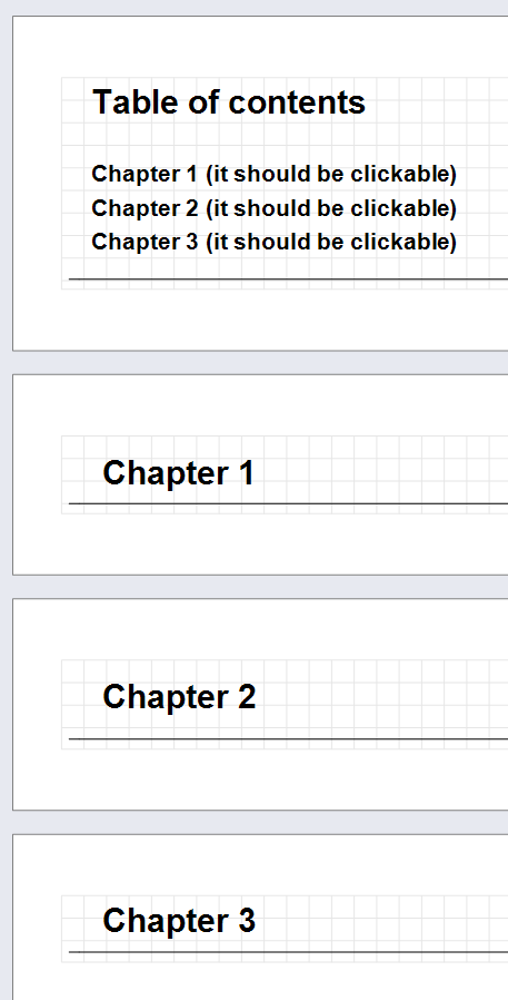

I have been using Smath for the last two years, but only basic stuffs.
Right now, I have a document that's a little bit long and I would like to add a table of contents with the ability to jump to the chapters, like in Word.
Is there a way to achieve this?

Hi Jean, thank you for your reply, but I am not sure I understood it. Maybe I wasn't clear, I have attached an image of what I pretend.

Hi Razonar, thank you for your reply. I downloaded the file, I think the table of contents is not clickable right? So, I would like to click over some chapter in the Table of Contents and Smath automatically jumps to the page where the chapter is located.

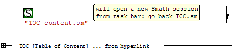

In the mean time you have Go to page
from the coded TOC, you can survive/access this demo.
Very easy to sanity QA my for 4 Clients from remote.
BTW, the Mathsoft page hyperlink was tested only, never used
in the Mathsoft Collaboratory over 10 years I shared.
Cheers, best ... Jean.
TOC [4 Clients Model].sm (205 KiB) downloaded 74 time(s).
