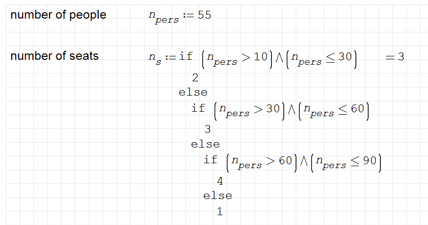

Hi I try to explain better what I want to calculate.
I would like to set up a for loop that allows me to do the same calculations as the if loop in the figure.
for example
if n.pers < 10 ---> n.s = 1
if n.pers > 10 & n.pers < 30 ---> n.s = 2
if n.pers > 30 & n.pers < 60 ---> n.s = 3
if n.pers > 60 & n.pers < 90 ---> n.s = 4
and so on
I don't know how if it's possible set up this cycle, anyway thanks.

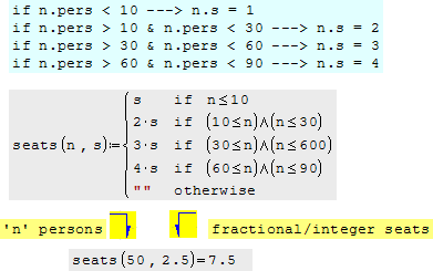

You don't need an iteration.
Ceil() and cases() shall work for you.
Davide Carpi 10/12/2021 4:15:00 PM

#7 Posted: 10/12/2021 2:38:28 PM
555 likes in 1333 posts.
Hi
I'm probably doing something wrong because, for exemple, with 40 or 70 it doesn't work.
Probably, please use the file below.
seats.sm (2 KiB) downloaded 67 time(s).
#8 Posted: 10/12/2021 2:50:02 PM
115 likes in 329 posts.
The suggestion of Overlord is correct. You can also define a function and make different corresponding values ​​calculate (using the Vectorize function)
number_seat.sm (6 KiB) downloaded 77 time(s).
