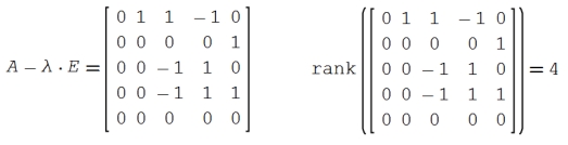

Hallo zusammen,
DimEigenraum: (n-rank(A-λ*E))=1@#
should be 2
some steps of elementary row additions later
is 2
https://de.smath.com/cloud/sheet/vooDFR4FbP
any idea whats wrong?

(%i6) A: matrix([1,1,1,-1,0],[0,1,0,0,1],[0,0,0,1,0],[0,0,-1,2,1],[0,0,0,0,1])$
(%i7) A-1*ident(5)$
(%i5) rank(A-1*ident(5));
(%o5) 3
but
Maxima(rank(A-1*identity(5)))=4
or

#7 Posted: 4/19/2020 11:51:44 PM
Alvaro Diaz Falconi
Alvaro Diaz Falconi
992 likes in 1675 posts.
Hi. You're right, it's a bug and there are no way to make this works (numerical nor symbolic):
First column is zero and 3th = - 4th columns, so can't be rank = 4.

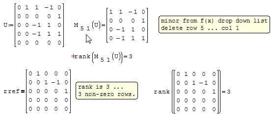

#8 Posted: 4/20/2020 11:51:33 AM
983 likes in 6866 posts.
and in how far do your example explain the incorrect calculation
Just advanced maths above the classroom.
Your example replies bug from incorrectly threaded input.
As given, your [5*5] matrix has no mathematical meaning.
Page1 rank.sm (11 KiB) downloaded 55 time(s).
