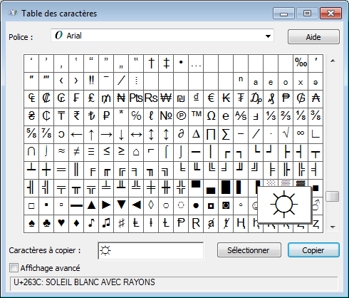

Hi IAks,
You don't need a plugin, just the right Unicode character (you can copy and paste the character from one site like Wikipedia, tamasoft.co.jp, alanwood.net or you can add the character holding the U and typing a #CODE# from the numpad)
look the attachments

#5 Posted: 11/7/2018 8:51:32 AM
I'm not sure why or how U+code was working in my previous Windows 7 OS...
I'm aware that paste doesn't work in variable typing (you can only select a whole variable and replace it); as workaround you have to build the variable in a text/writer region (or notepad) and paste it.
If you use writer region and you know the character code you can use CTRL+SHIFT+X (on hexadecimal code) / CTRL+SHIFT+D (on decimal code)
Without cnversion, in any text editor/region you have to wrap the uppercase code in slashes
All numbers are available as subscript/superscipt characters, although superscript 123 are in a different unicode block and might be rendered differently (uniode superscript/subscript ).
SO4\207B\\00B2\
¹²³⁴⁵⁶⁷⁸⁹⁰⁺⁻

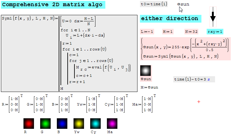

Hi. You can use this for not leave SMath and get the unicode chars that you want:
UNICODE_VAR.sm (2 KiB) downloaded 89 time(s).
Notice that you must to split the unicode char for preventing it substitution with the char itself when copy and paste the expression.

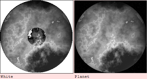

WroteIn astronomy I need to use a symbol that looks like a circle with a dot in the middle as a subscript
... from 6 years old .
Tentatively we can highlight a specific circular region.
The attached were left unfinished.
Image Planet Luminosity_1.sm (100 KiB) downloaded 73 time(s).
Image Planet c(planet)planet.sm (79 KiB) downloaded 72 time(s).
Image Planet fmap.sm (183 KiB) downloaded 70 time(s).
Image Planet Luminosity.sm (219 KiB) downloaded 73 time(s).
Image Planet Luminosity_2.sm (236 KiB) downloaded 73 time(s).
Image Planet Gamma.sm (315 KiB) downloaded 76 time(s).
