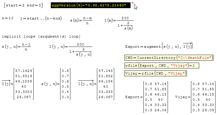

you divide by a vector. If you want to apply that by element, then use the vectorize operator.
Alternatively, you can use implicit loops.
In any case make sure that you don't divide by zero.

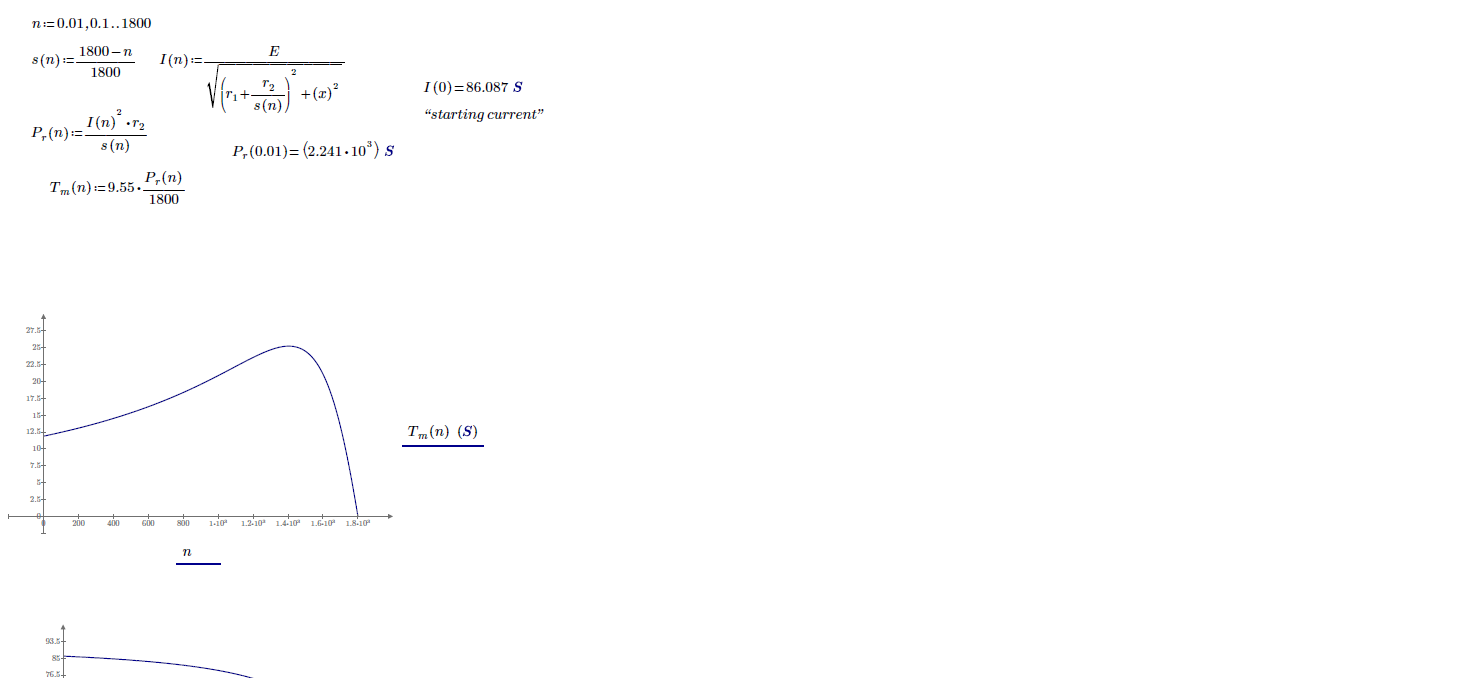

#8 Posted: 3/15/2018 6:34:53 PM
983 likes in 6866 posts.
Too many parameters are missing to reproduce
r1, r2, E, x [u in Smath ... back to x in plot]

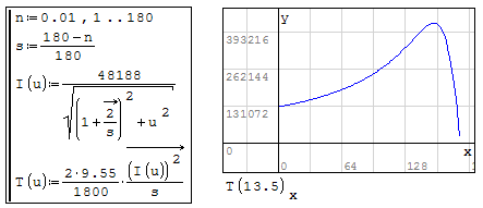

Thank you for your efforts, that's what I am looking for. I am resending the data with all the information. I have a few questions on your previous post, there is an arrow above 2/s and I(u)^2.What is that function. Also, you have used the value of u = 13.5? Also, when you plot the graph, did you just type T(13.5) to get the graph?
#10 Posted: 3/16/2018 12:18:34 AM
I am re-sending the data with all the information.
1. The arrow is the vectorising operator [same as Mathcad].
2. 'u' is the wild parameter of same nature as r1,r2
3. The system runs over 'n' taken into account wrt the vectorised arguments.
4. Shift@ to get the plot region, type T(13.5) then [ to get the index operator
then type x. The Smath plot argument is 'x'. So, by indexing, it will plot over
the running 'x'. If you want to plot ln(x), just type ln(x) in the plot place holder.
I will try to code your latest information, but busy next three days.

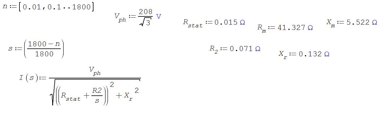

#12 Posted: 3/16/2018 7:46:41 AM
1418 likes in 2874 posts.
starting from the basics, hope it might help you
example.sm (17 KiB) downloaded 203 time(s).
Thank you so much, this really helps. May I suggest you post this as an example so everyone can benefit.

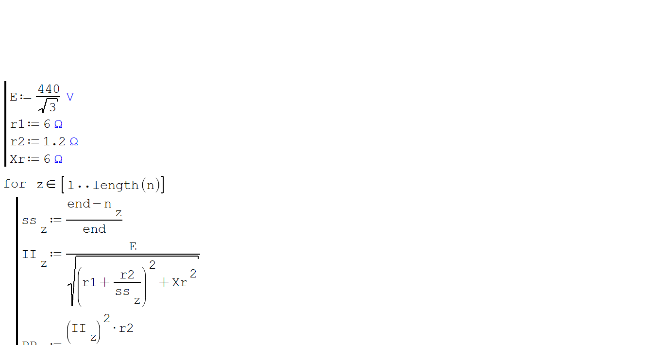

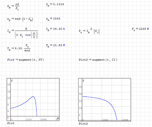

#18 Posted: 3/16/2018 7:47:03 PM
CBG
CBG
77 likes in 312 posts.
Something like this?
Vijay_CBG_Jean.sm (13 KiB) downloaded 79 time(s).
Carlos
Thank you Carlos, just one question, how did you create the vertical line with multiple entries.
