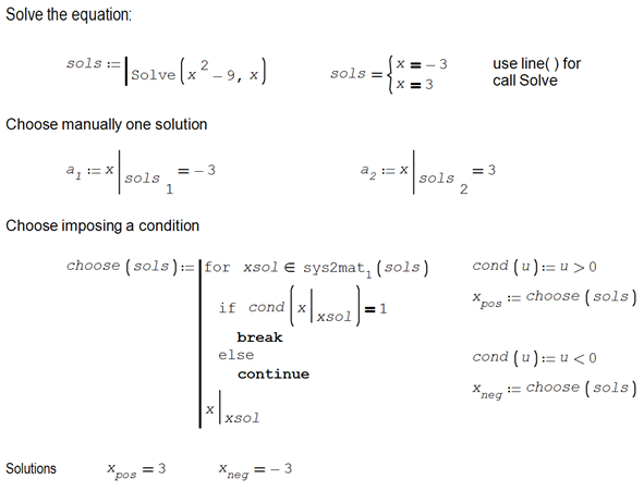

Hi. You can try this approach.
filter maxima solve solution - choose.sm (8 KiB) downloaded 96 time(s).

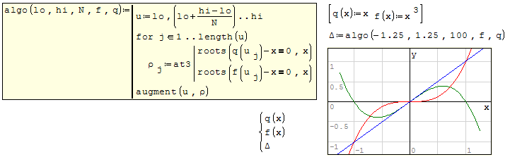

983 likes in 6866 posts.
I've became an addicted of the Maxima Solve() function, but I am finding some trouble handling cases where one variable has multiple solutions.
That visit will help.
Solve roots LAGRANGIAN.sm (188 KiB) downloaded 77 time(s).

Thanks! Very interesting use of the at() function, I didn't know it could be used with Boolean also. I not fully understand what the line() does to Solve(), but I tried without and and seen for myself that it will not work without.

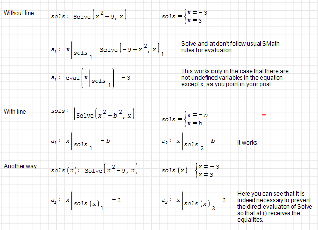

... I not fully understand what the line() does to Solve(), but I tried without and and seen for myself that it will not work without.
Hi. line( ) does the same as defining sols (u) = Solve (eq, u)
filter maxima solve solution - line.sm (11 KiB) downloaded 82 time(s).
