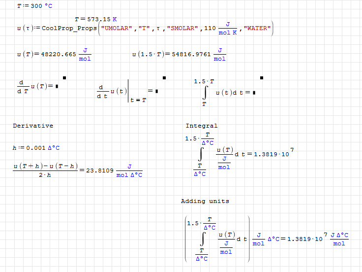

Hi. How can take the derivative or integral of a function involving coolprops?

#2 Posted: 1/28/2018 6:41:06 AM
Hello Alvaro,
I have the impression that numerical derivative and integration issues (especially with units) will be here on the Forum for ever
. I wish I was wrong.
The analytical attempts with Maple or Maxima will fail here. We are forced to use numerical solvers or functions here. Here is the solution (not straight forward though) only in SMath.
I tried Gradient.CD() from NumericalSolvers plugin, but I failed.

#3 Posted: 1/28/2018 7:11:32 AM
Aside smath issues, you can use the coolprop derivatives syntax (units not handled here, wrapper stuff to check)

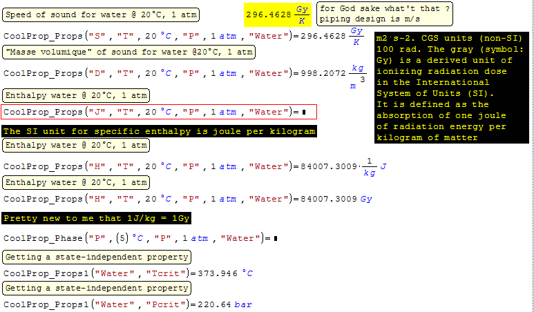

#6 Posted: 1/29/2018 3:11:21 AM

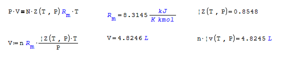

#7 Posted: 1/29/2018 10:25:08 AM
Here what can I do, but guess that not much more, at least without an equivalent of wolfram's Hold or maple's x::uneval. I don't see any other way for handle the case with 2 variables, i.e. h(s,v), u(T,P) etc and have a true readable implementation of classic thermodynamics.
