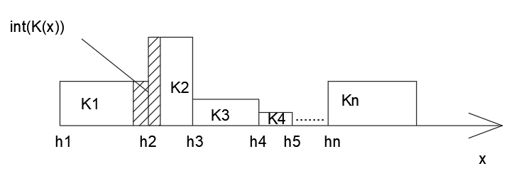

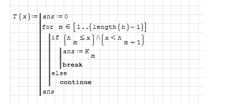

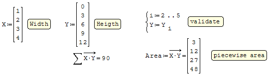

I'm trying to write a function that I can use to calculate the surface area. The function is to be based on data from a matrix with n elements
I ran out of ideas. I guess the problem is in a loop.
I attach a file and an image.
I will be grateful for your help.

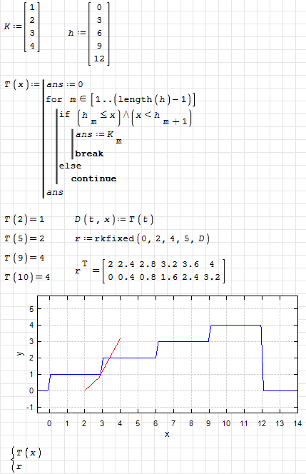

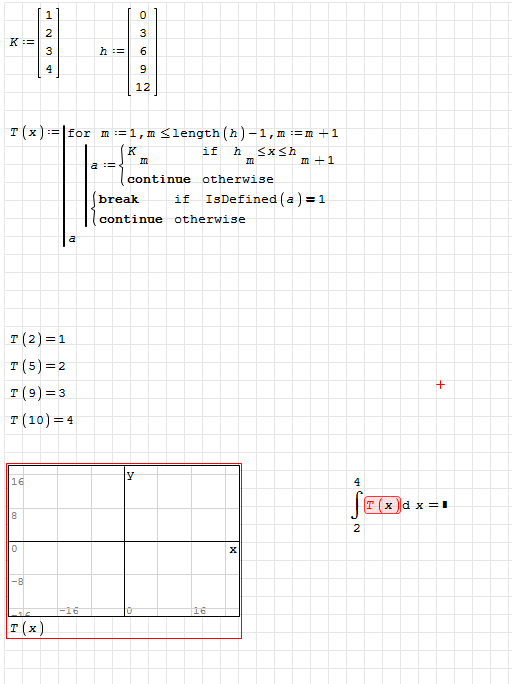

#2 Posted: 9/20/2019 5:22:30 PM
Arie
Arie
93 likes in 285 posts.
You can define piecewise function this way. Haven't figured out integration yet. Built in int() function doesn't seem to work.

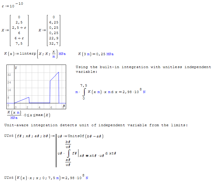

#6 Posted: 9/20/2019 8:46:37 PM
1402 likes in 1708 posts.
You can try something like this

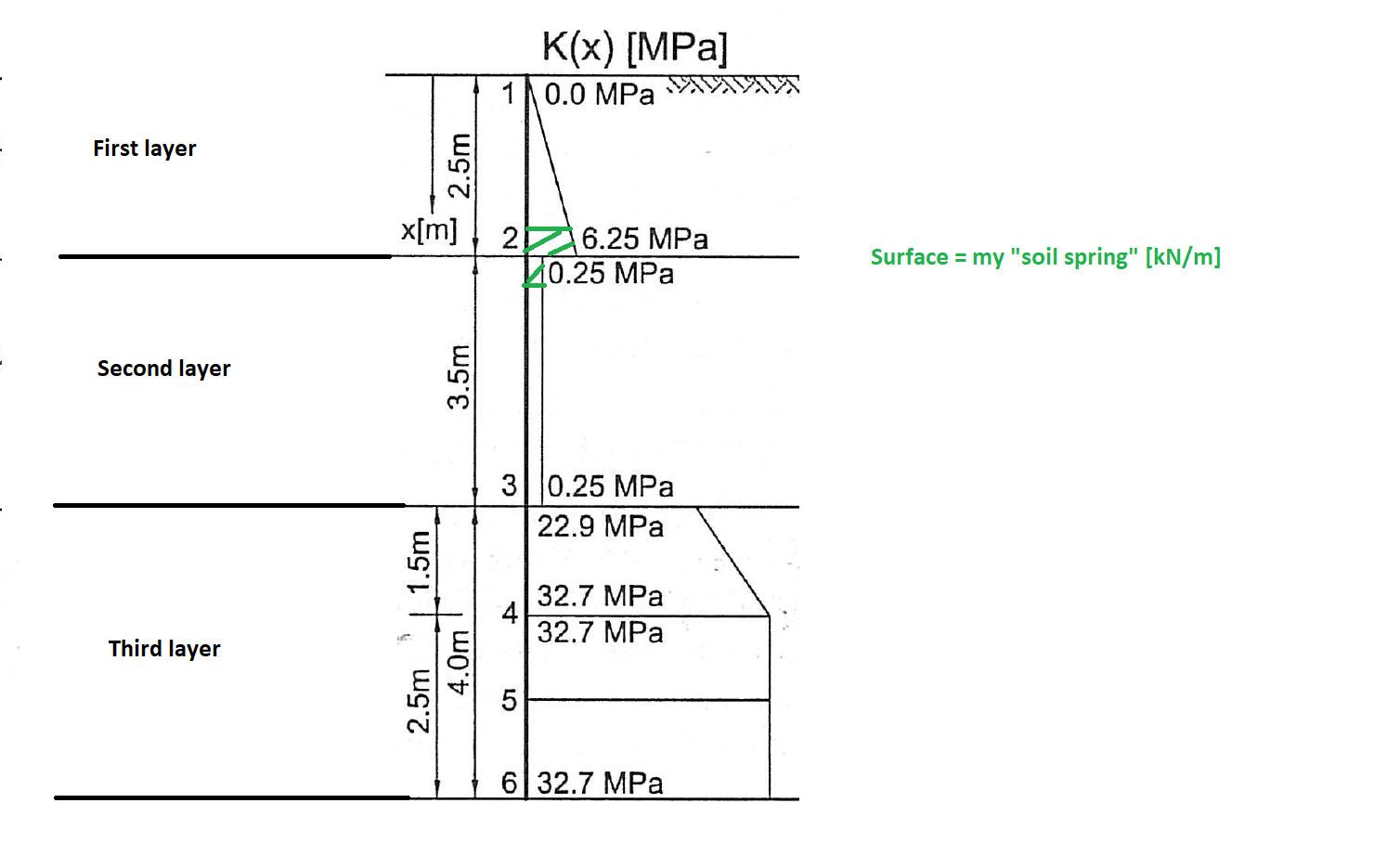

Thank you guys for your answers,
I will try to explain what I need.
Depending on the soil layers, I have a graph similar to the picture. At a later stage, I want to divide this chart into equal pieces (for example 0.25 m or 0.5m) to obtain "soil springs".
To simplify the example, I assumed that the elements of the K matrix are constant.

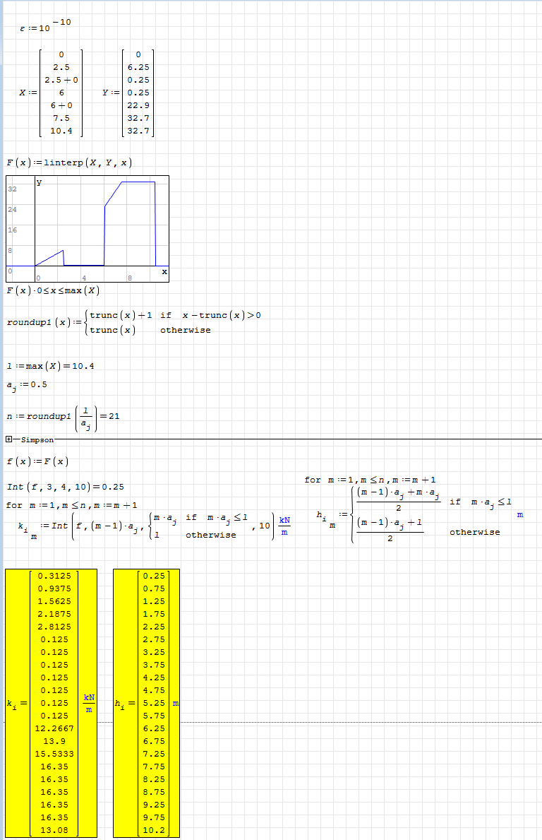

#14 Posted: 9/22/2019 6:57:11 AM
XiuPer
XiuPer
0 likes in 3 posts.
Thank you very much,
(btw the "thank" button on this page does not work)
The idea of ​​using linterp is actually much better instead of a loop.
Below is the file with the result I needed.
Final springs.sm (20 KiB) downloaded 53 time(s).
#15 Posted: 9/22/2019 9:43:08 AM
983 likes in 6866 posts.
The idea of using linterp is actually much better instead of a loop.
The "Tanks" button used to work years ago, not any more.
Good work ... two comments:
1. subscript is confusing with sub-sub index.
Very many projects are sub-sub indexed.
Reserve subscript as tutorial [exemplified].
2. variable name confusing with number is another killer.
you had 1:=max(X).
SS7030 was reputed good version, compatible SS 6179.
Final springs_1.sm (24 KiB) downloaded 61 time(s).
