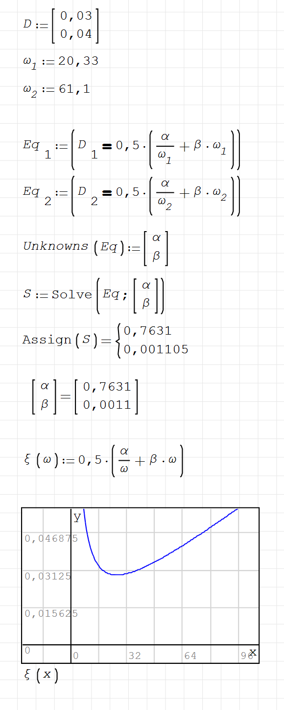

#2 Posted: 4/5/2022 4:39:40 PM
115 likes in 329 posts.
Show Spoiler
test_sergio.sm (8 KiB) downloaded 91 time(s).
Mo 4/5/2022 10:22:00 PM

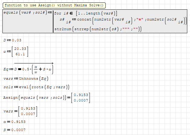

#3 Posted: 4/5/2022 6:24:50 PM
555 likes in 1333 posts.
You can use roots() for your function. And a vectorize() can simplify it.
However, to use Assign() you will need this function to merge vars and solutions.
Assign_without_Maxima Solve().sm (7 KiB) downloaded 79 time(s).

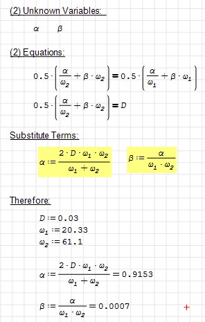

Greetings,
Another approach would be to use some elbow grease, you can substitute terms by hand and solve for 𝛼 and 𝛽:
Keypress (You can copy/paste the following into your worksheet):
α:{2*D*ω.1*ω.2}/{ω.1+ω.2}
β:α/{ω.1*ω.2}
*NOTE: ω.1 and ω.2 shown above are variables with subscript, they are not vectors ω[1 and ω[2; You should be able to substitute ω.1 for ω[1 if that serves your purposes.
- Kenny Lemens, P.E.

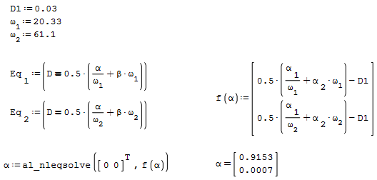

#6 Posted: 4/6/2022 11:40:36 AM
Fridel Selitsky
Fridel Selitsky
520 likes in 451 posts.
If the damping coefficients are denoted by α1 and α2, you can use the function al_nlegsoive
test.sm (6 KiB) downloaded 66 time(s).
sergio 4/6/2022 12:26:00 PM, Mo 4/6/2022 11:57:00 AM

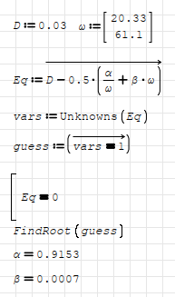

solving with uni's latest addition mathcad blocks;
you wouldn't need Eq: actually, but it can be shown.
mathblock.sm (5 KiB) downloaded 75 time(s).
Mo 4/9/2022 10:28:00 PM
#10 Posted: 4/7/2022 6:19:34 PM
I think this is the most sophisticated method of my way.
It can get unknowns from equation, solve them.
In the end assigns numerical values to unknowns.
You don't need to define alpha or beta or any variable.
All process is automatic.
mathblock_v2.sm (5 KiB) downloaded 75 time(s).

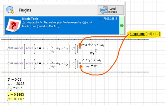

#13 Posted: 4/11/2022 9:57:44 AM
⚜ Kenny Lemens, P.E. ᵂᴵ
74 likes in 164 posts.
Greetings,
If plugins are considered, you can also consider the use of Maple:
In the image I posted, the 'equal sign' shown on those two equations are actually symbolic equals; keypress: [ctrl] + [.] instead of keypress [=].
Kenny Lemens, P.E.

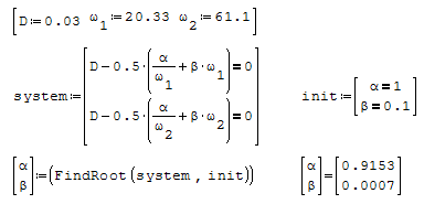

#16 Posted: 4/14/2022 2:54:00 PM
983 likes in 6866 posts.
Thank you all for the feedback, is there a literature or manual to explain the Mathcad block plugin ?
For that particular example, maple is an algebraic export.
Mathcad block has not yet been exemplified in Smath Community
of what it can do vs what native Smath can't.
Cheers ... Jean.
Codes Solve.sm (12 KiB) downloaded 68 time(s).
