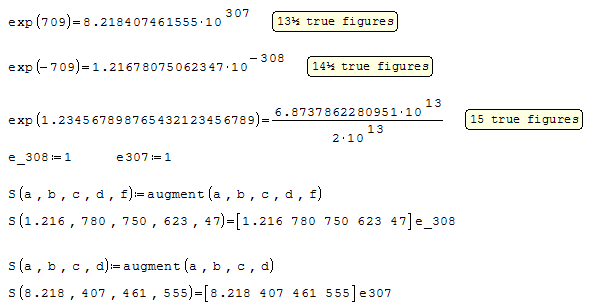

Not so much use, whereas no CAS displays/accesses > 15 figures
Utilities Round(U,n).sm (13 KiB) downloaded 46 time(s).
