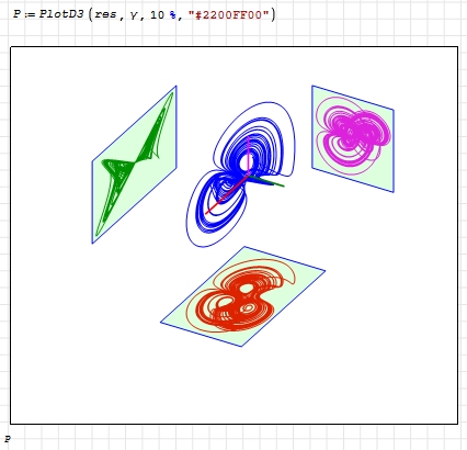

Hi. For show the four plots at once.
DadrasAttractor.sm (46 KiB) downloaded 79 time(s).
Fridel Selitsky 7/27/2021 3:46:00 AM
#6 Posted: 7/27/2021 2:58:38 AM
netsonicyxf
netsonicyxf
2 likes in 79 posts.
Thanks for the 3D image
