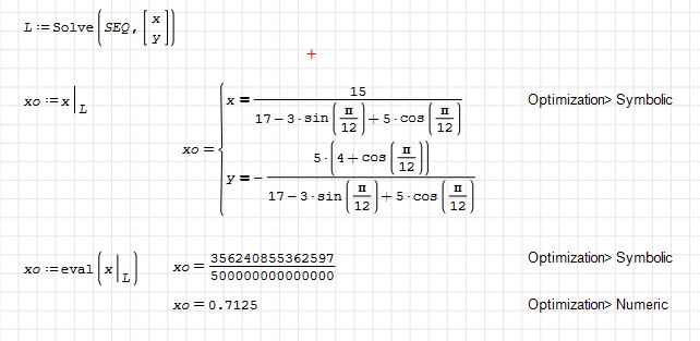

How to turn of the decimal values in trygonometry angles value? I got sth lik this for solution of system of equations:
The file with example: example_v1.sm (8 KiB) downloaded 39 time(s).
A.

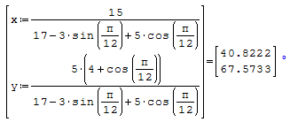

You can use the function al_nlegsolve with any initial
assumptions (because the equations are linear)
al_nlegsolve.sm (11 KiB) downloaded 57 time(s).

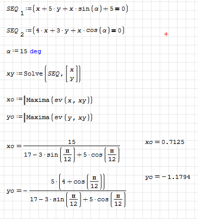

Hi. You also can use Maxima commands, in this case ev():

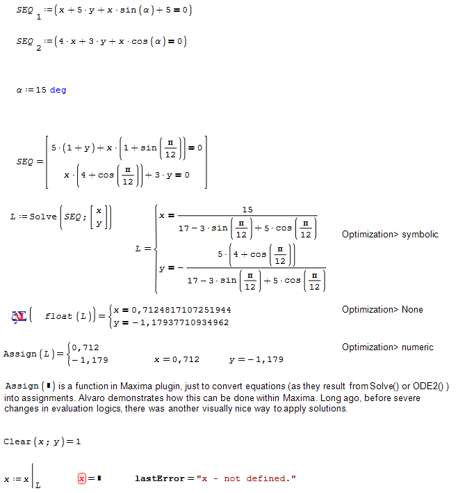

#5 Posted: 9/10/2021 5:37:18 AM
1222 likes in 2150 posts.
example_v1.sm (13 KiB) downloaded 49 time(s).

Hi Martin. I use Maxima's ev() because SMath's Assign() only works with the variable names, instead others, like xo, yo, and SMath's at() doesn't works for the symbolic evaluation, as shown this picture:
example_v1.sm (15 KiB) downloaded 43 time(s).
This is a workaround for use only SMath native functions or plugins, without any explicit Maxima function:
example_v2.sm (15 KiB) downloaded 47 time(s).
