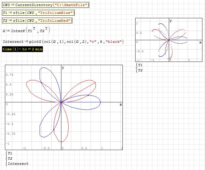

#39 Posted: 2/18/2018 10:58:48 PM
983 likes in 6866 posts.
Hello Marco,
I'm trying for the intersection of the two Trifolium, .
blue => native ... red => rotated.
They are created in "Page1 Trifolium.sm
Then recalled for the InterX(T1,T2)
Nothing happens >>> 1 hr ? [Win 7 Starter Edition ... 1.66 GHz]
Is it supposed to work ? Thanks in advance.
Page1 Trifolium.sm (32 KiB) downloaded 52 time(s).
Maths InterseX [Marco].sm (51 KiB) downloaded 53 time(s).
#40 Posted: 2/19/2018 12:26:16 AM
Alvaro Diaz Falconi
Alvaro Diaz Falconi
992 likes in 1675 posts.
Hi Jean.
You are using an old version of the program. Try this one.
Notice that the point (0,0) is found several times by the algorithm. It could be interesting to check if it get the correct number of crosses at the origin.
InterX.r1 - ranged indices_alyles.sm (88 KiB) downloaded 70 time(s).
