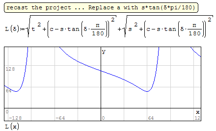

#9 Posted: 10/14/2019 3:31:04 PM
... You can have it to a good degree of accuracy
as a continuous function, though a bit strange.
Reflection [abst, alyles].sm (252 KiB) downloaded 48 time(s).
#10 Posted: 10/14/2019 4:00:54 PM
Wrote... You can have it to a good degree of accuracy
FYI Jean you're using one of my earlier files where I had a copy paste error in the derivation of L(d), the second root term should only have s*tan(d*pi/180). You can get rid of the "c-"
#11 Posted: 10/14/2019 5:47:14 PM
WroteFYI Jean you're using one of my earlier files where I had a copy paste error in the derivation of L(d), the second root term should only have s*tan(d*pi/180). You can get rid of the "c-"
Thanks ... updated.
The model fit is brute force, limited.
From my 100's models, not one immediate.
If interested: let me know, not sure if possible.
Reflection [abst, alyles].sm (209 KiB) downloaded 46 time(s).
