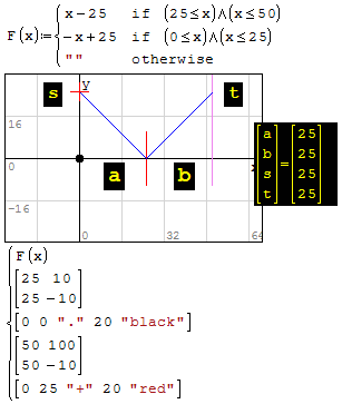

You are missing to plot the literal demo diagram,
here is as per your inputs [a,b,s,t].
More is missing from incomplete project description.
Reflection [abst].sm (62 KiB) downloaded 49 time(s).
Refreshed from your literal inputs.
You may have to revisit your College Physics book.
Cheers ... Don't hesitate.
Reflection [abst].sm (128 KiB) downloaded 52 time(s).

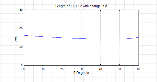

Yes the length L is continuous with respect to ddegrees. I think Jean misunderstands the question. See attached. (A little sloppy but it works)
Edit: Updated graph to add labels
Edit2: Had an error in definition of L. Fixed.
Reflection_alyles.sm (177 KiB) downloaded 49 time(s).
Quite right: misunderstood the travelling distance vs °incidence.
Thanks, interesting project. We need more real projects.
Reflection [abst, alyles].sm (186 KiB) downloaded 48 time(s).

... You can have it to a good degree of accuracy
as a continuous function, though a bit strange.
FYI Jean you're using one of my earlier files where I had a copy paste error in the derivation of L(d), the second root term should only have s*tan(d*pi/180). You can get rid of the "c-"
