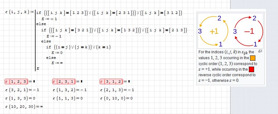

I have a symbol that nearly works for all cases. At the moment I am not sure how to get the first IF statement to work.

Hi. The "E" in the first if isn't the same "E" than the others. You can see that looking that the bakground isn't gray, like in all others.
That fixed it Alvaro! ...
