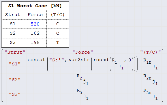

What I want to do is have a specific cell in a table with bold text. This particular cell should always be bold and red.
It seems that the table region only allows for the formatting on the entire body, header, etc., and not single cells.
The best I have been able to do is convert my variable to a string and use the units display trick to make my value display like a unit (blue), instead of black like the rest of the cells.
Can something similar be done to make it bold, and red?
Hopefully this hasn't been asked and answered. I tried looking through the forum, but didn't find anything that could solve this for me.
Thanks for the help.

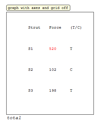

An alternative is using formatted colors in a graph.
Please see attached file:
TextInColor.sm (10 KiB) downloaded 88 time(s).
Well, this one option, but it’s definitely not very clean looking as compared to the table. Thanks for the input.

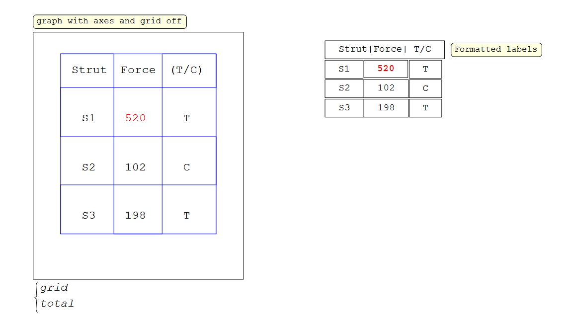

Ok, here is another options...
Please see updated file: TextInColor.sm (20 KiB) downloaded 95 time(s).

Thanks for the input guys. All good ideas. I might end up sticking with what I have already just because it is so much more simple. Working with the Viewer, so trying to keep things light and simple.
