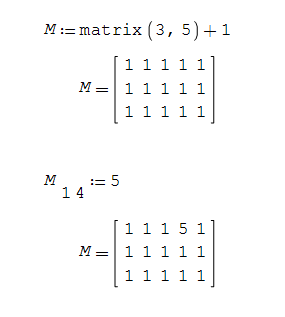

#3 Posted: 9/28/2021 8:37:33 AM
1418 likes in 2874 posts.

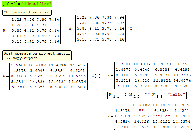

#4 Posted: 9/28/2021 9:17:41 AM
983 likes in 6866 posts.
... observe the empty place holder is a / operator.

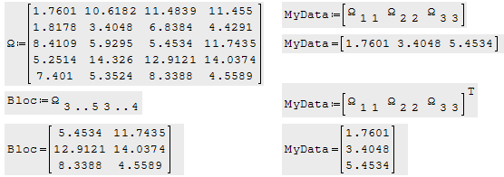

#6 Posted: 9/28/2021 11:15:31 AM
Thank You Jean, but rather, I meant to extract a specific element from the matrix.
There are many more ways ... like skinning a cat.
Cheers ... Jean.

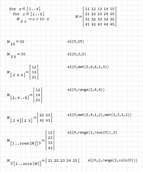

#8 Posted: 9/28/2021 4:21:01 PM
Alvaro Diaz Falconi
Alvaro Diaz Falconi
997 likes in 1676 posts.
Hi. There are many different ways to access the elements of an array. This list is not exhaustive, and does not include the submatrix function.
M.sm (10 KiB) downloaded 86 time(s).

#11 Posted: 9/30/2021 1:37:31 PM
Alvaro Diaz Falconi
Alvaro Diaz Falconi
... One more thing, how do you write the range of elements in an array? Regards Adam
Use vector element
or matrix element
and then put a range (with 2 or 3 arguments) in the index placeholder
