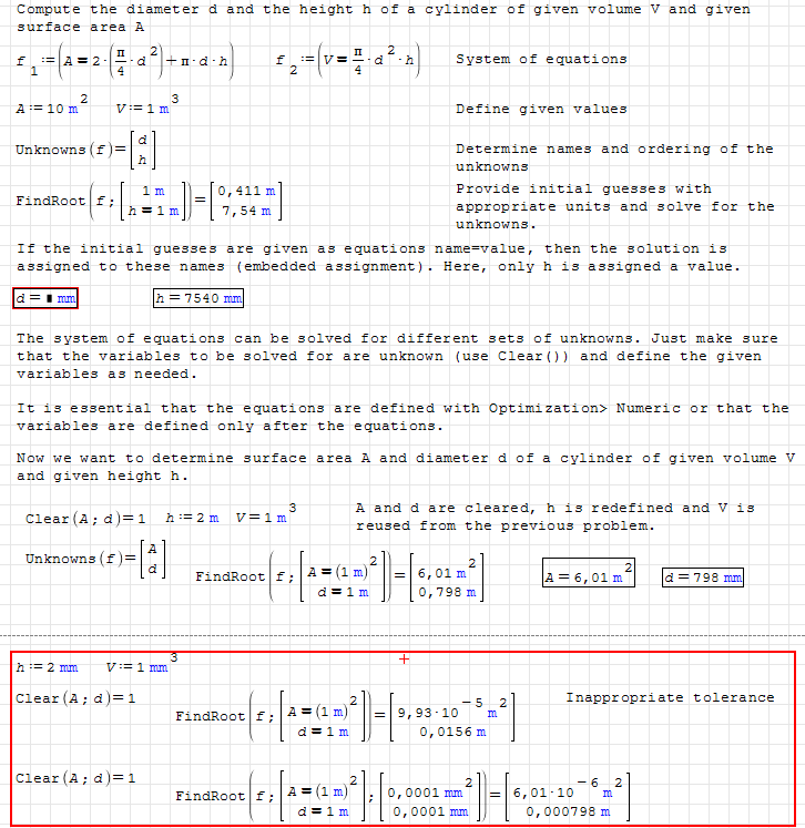

FindRoot() internally converts the numbers to base units (meter). The default tolerance of 0.0001 for variable and function is to be interpreted in the base unit of the given quantity.
In the first example with volume and height being close to unity in base units, the default tolerance is appropriate.
If the dimensions are scaled by factor 0.001 (mm instead of m) then the tolerance is nearly of the same magnitude as the variable. The result is complete rubbish. The problem is fixed by adjustment of the tolerances.
findroot.sm (29 KiB) downloaded 73 time(s).
