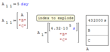

Smath Studio fails when a table containing arrays is inserted, and closes unexpectedly.

may be this helps better to understand the situation here.
correction: force close occurs if the first element of matrix is a string.

Here is the latest deal, I have created a portable 6606 version which has no extension plugin except table region.
Now the table plugin is working as it should be. Maybe one of the installed plugins is creating the havoc.
I am going to try to find it by installing one at a time.

Andrey,
Could you please change your decimal symbol from comma to period and try to open the test file above?
I think I have found the culprit. When I change it to comma, no issues so far.

Thank you very much! I will check decimal symbol and will try to fix the plugin asap.

Issue is reproduced. Working to investigate and fix.
#15 Posted: 2/6/2018 8:16:31 PM
2276 likes in 3759 posts.
Please could you try to update plug-in and test your examples?
I think I have fixed the issue.

Table region is not causing force crash.
Everything seems good, congrats.

Now the example works very well.
