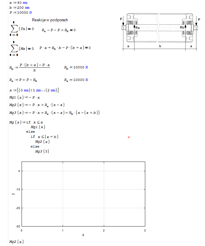

Hi everyone. In work I used MathCad, but when I heared about Smath Studio - I wanna try it at home. But..... I have problem. I want to rewrite one calculation sheet from MathCad to Smath.

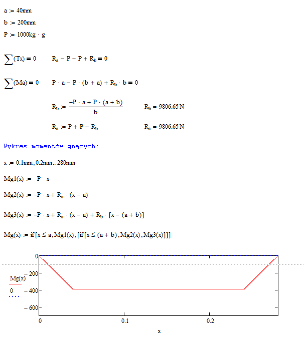

Here is fragment from MathCad: 1.PNG
I try to rewrite the same calculation to Smath but I can't correctly generate plot: 2.PNG
What I do wrong? I can't find error. BTW: I can't apply "x" range like I made it in MathCad.Can someone help me? Maybe make simple working file with solution on my problem? I already don't have any idea... I try for few days after works.

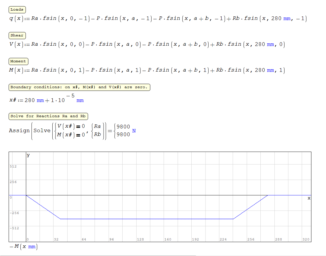

Hi!
Here is a little different way to express your model and find your answer, maybe it could be interesting:
You can download the Smath file here: BySingularityFunctions.sm (25 KiB) downloaded 76 time(s).
