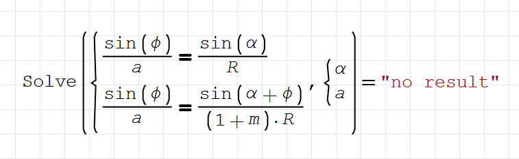

Thanks Jean,
Both a and alpha are unknows.
the result of a and alpha are still includes these unknows.
Only φ, R and m are knowns and can be used in the results.

Thanks Jean,
Buy you 2nd sybolic solution is the same as the 1st one.
The solution should not include the unknow a and alpha

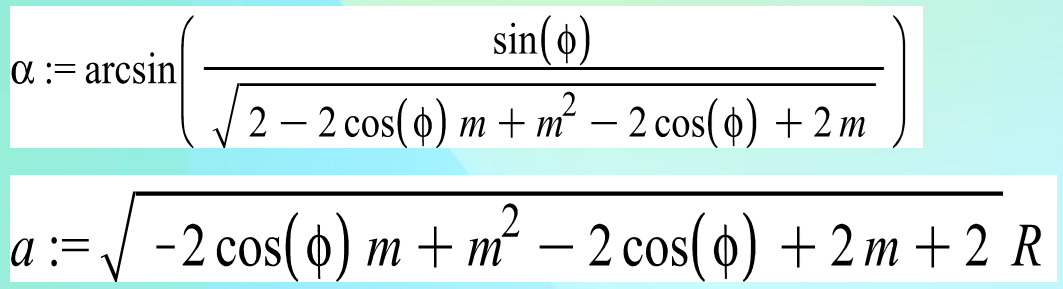

My friend use Maple to get symbolic solution like this
You can see that in the solution of alpha, there is no a, in the solution of a, there is no alpha.

Symbolic solver of maxima is not that capable.
As far as I know of course, maybe there is a simpler way.
But this statement was what I had read about it.
You have to use some substitutions for that solutions.
And some extra division, arc functions, visa versa.
Here is α solved symbolically in wxMaxima.
Same method can be applicable for variable a.
untitled.wxmx.zip (1 KiB) downloaded 70 time(s).

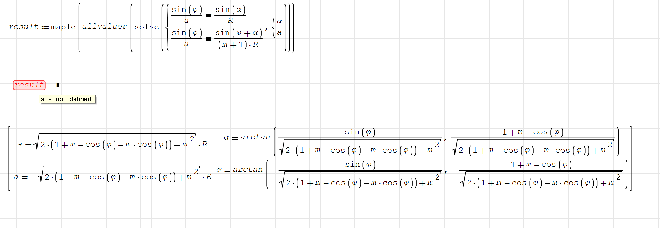

In the example below, I solved your function with Maple.
Though it gives the results correct, result matrix is cripled.
Copying and changing last bits of result ";2;1)" to ";2;2)" will correct the result.
";" may differ to "," according to your arguments separator.
Worksheet1.sm (15 KiB) downloaded 106 time(s).

Is Maple plugin in Smath able to get symbolic results as Maxima does, but more
Hi overload,
When I open you sm I get this error
appears in red, because the evaluation must be symbolic.
select the "result" variable, press the right button and in the type of evaluation select symbolic and that's it.
I hope I have served you, greetings

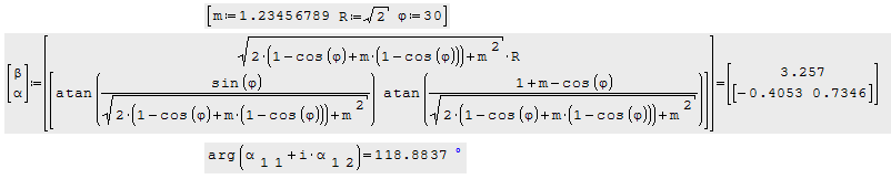

Hi. Another way, applying trigonometric identities.
solve_trig.sm (12 KiB) downloaded 86 time(s).
#12 Posted: 4/17/2022 8:32:35 AM
983 likes in 6866 posts.
Thanks Jean,
Both beta and alpha are unknown.
the result of beta and alpha still include these unknowns.
Onlyφ, R and m are known and can be used in the results.
... to be used as productive.
Your system is baby stuff, example 2 advanced.
I leave it there, not knowing more about your end demand.
Simply a solved formula representation ???
Comment or ignore ... Jean.
Solve ADVANCED Productive.sm (22 KiB) downloaded 77 time(s).
Addition to churichuro's reply, use this simple function to correct maple plugin result matrices.
maplecorrect.sm (26 KiB) downloaded 170 time(s).
