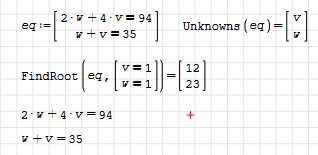

Hi, Guys:
I'm using FindRoot for SOE solution,but something make me confusion. for example:
the same SOE with different variables, different result, and the second is wrong.
I think maybe I have something wrong. please help me, how to use the FindRoot?
Thanks a lot!
John

#2 Posted: 5/11/2022 12:24:23 AM
Alvaro Diaz Falconi
Alvaro Diaz Falconi
997 likes in 1676 posts.
Hi. You must to sort the variables in the same order than Unknowns.
Hi, is there any rules for the order?
Thanks alot
John
#4 Posted: 5/11/2022 3:32:40 AM
Alvaro Diaz Falconi
Alvaro Diaz Falconi
Hi. You can't redefine Unknowns. Well, you can, but isn't the best idea. Unknowns is a function in the same plugin than FindRoots, SpecialSolvers. I don't know the internals of the plugin. My guess that the general rule is sort the variable names in lexical order, but if the name has unicode characters or some unusual ASCII character, it is best to make sure of the order to follow by evaluating Unknows(eq).

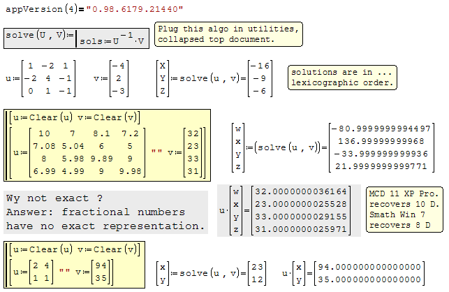

#11 Posted: 5/12/2022 8:44:12 AM
983 likes in 6866 posts.
For your example, make it algo style for local infinite use.
Observe ... sols:=U^-1*V is universal outside of Smath Plugin(s)
... your question about order of vars
solutions are by convention in descending order of the pair wise u, v
no matter the names you give.
I can't explain the decimals difference between MCD 11/Smath.
There are other constants that can't be found exactly ...
Pitot constant, Goat radius constant ...
That remark applies to any solvers [Smath and wrt any CAS]
The U^1*V is the core component of the Cholesky solver
as applied to fitting model function to a data set.
In that case, best fit is obtained by iterating the Genfit.
Chers ... Jean.

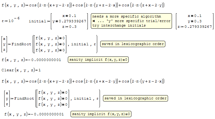

#12 Posted: 5/12/2022 9:46:19 AM
... here, you can push the cork in the bottle to accommodate irrational pi.
as well ignore epsilon.
#13 Posted: 5/12/2022 10:11:31 AM
... as it looks, the max I could push the cork in the bottle
y≡0.279339266990994 ... sanity f(x,y,z)=-0.000000000001344
Confirms impossible exactly solving irrational numbers.
