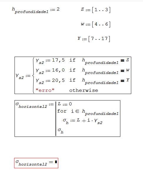

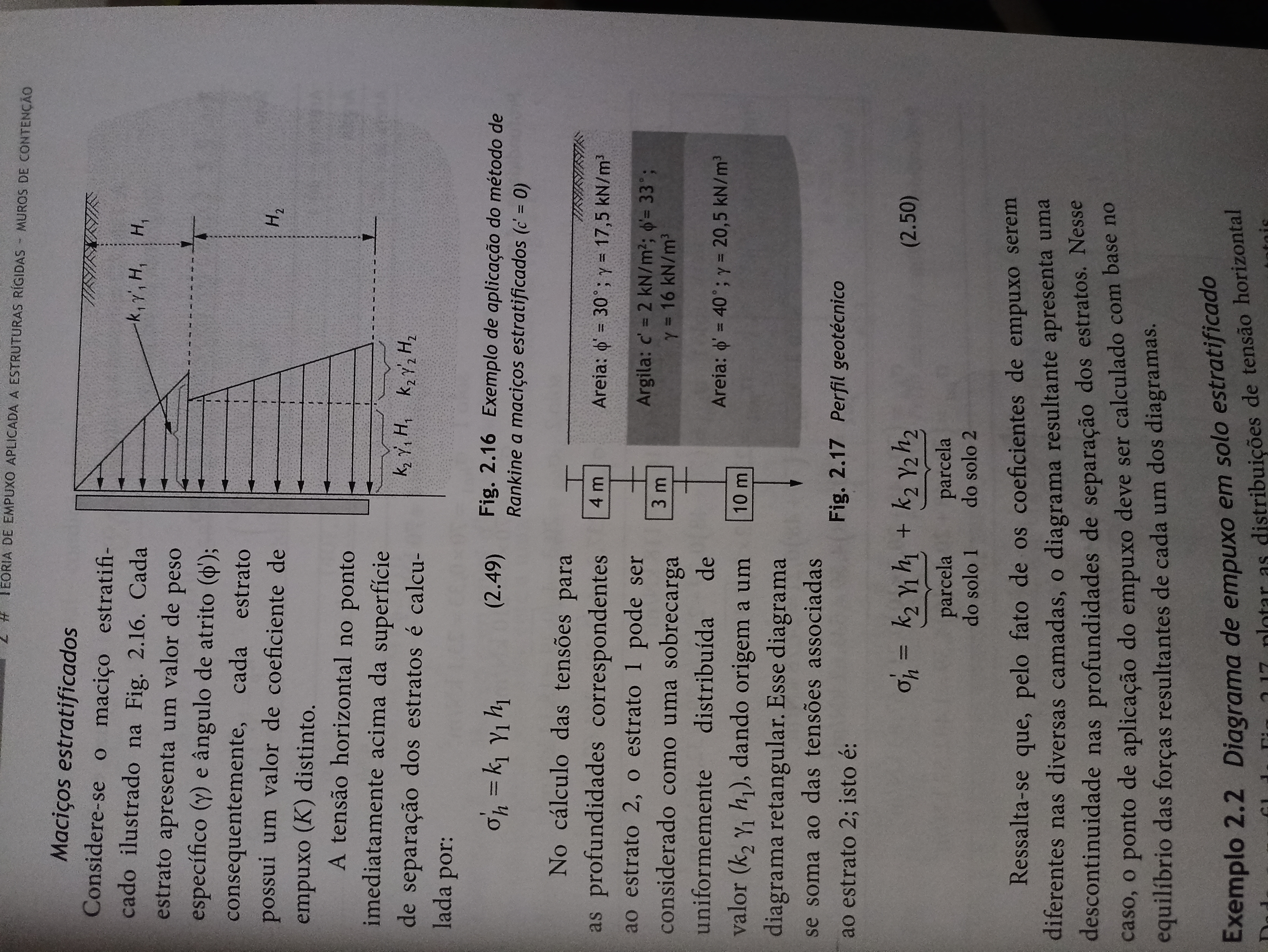

Good afternoon, could someone explain to me how to solve this problem I need that the horizontal voltage varies according to the depth however and the s2 gamma.
my input data is hprofundidade1 z w and y
TESTE TENSAO ADM MATRIZ.sm (5 KiB) downloaded 67 time(s).

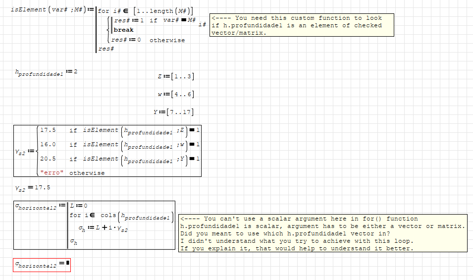

WroteGood afternoon, could someone explain to me how to solve this problem I need that the horizontal voltage varies according to the depth however and the s2 gamma.
I didn't understand what to calculate in sigma function.
A little more explanation would help to resolve it.

I reworded the file with an SPT matrix, my goal is to loop to find the value of sigma h in the depth that I inform in the input I am attaching a photo of what the final result should look like with the graph

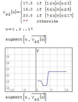

#4 Posted: 1/6/2022 3:04:40 PM
Hi. I think that this could be the solution.
TESTE TENSAO ADM MATRIZ.sm (5 KiB) downloaded 79 time(s).

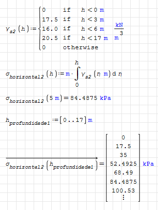

#5 Posted: 1/6/2022 4:49:36 PM
WroteHi. I think that this could be the solution.
I still don't understand purpose of for() loops. (not in your solution, original question)
Removing for()'s and calculating directly won't change the result.

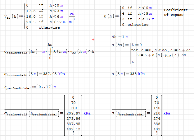

#6 Posted: 1/6/2022 7:06:33 PM
WroteWroteHi. I think that this could be the solution.
Hi overlord. I guess because using γ.s2(h)*h isn't correct, there the correct acumulation is γ.s2(h)*Δh
TESTE TENSAO ADM MATRIZ.sm (10 KiB) downloaded 75 time(s).

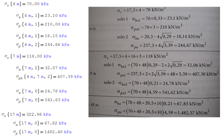

WroteWrotethank you all for making your time available, helping me with this problem but some of the solutions posted here do not match the values must be equal to sigma,v in the image or 70 kN/m2 at 4m depth and 118 kN/m2 at 7m depth.

PERFECT FELL LIKE A GLOVE is there a way to rotate the result of the graph 90 degrees?

This is a way to do that in SMath.
TESTE TENSAO ADM MATRIZ v2.sm (455 KiB) downloaded 82 time(s).

Thank you all for making your time available, helping me with this problem but some of the solutions posted here do not match the values must be equal to sigma,v in the image or 70 kN/m2 at 4m depth and 118 kN/m2 at 7m depth.
see the resolution of the problem in the attached image
