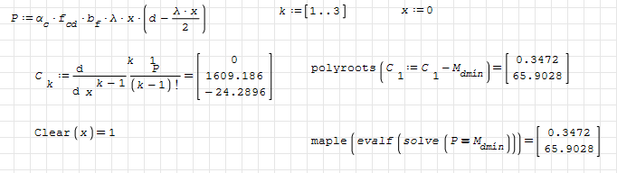

Good morning, I'm new to Smath Studio, I would like to know if it is possible to obtain the same result that was obtained in mathcad prime 6.0
math cad prime 6.0
https://i.ibb.co/S76VZZY/mathcad.png

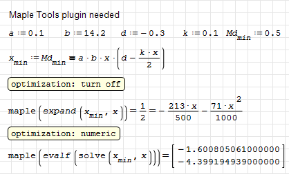

Hi Tiago. This is one way.
#6 Posted: 12/9/2021 12:56:18 PM

I need this display after the expand
https://ibb.co/Sfmj1jz

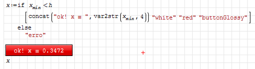

I need the blue rectangle to be the same as the yellow one, is this possible?
https://ibb.co/2n6Np5C
not the end result but what is between expand and solve
The polynomial coefficients?
Not possible to easily write all those functions in one line.
It can be done with serious alterations but shall not be practical.
I posted something similar to another user. But again, I wouldn't use it.
Just write functions and solves in multiple lines.
