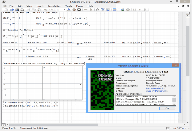

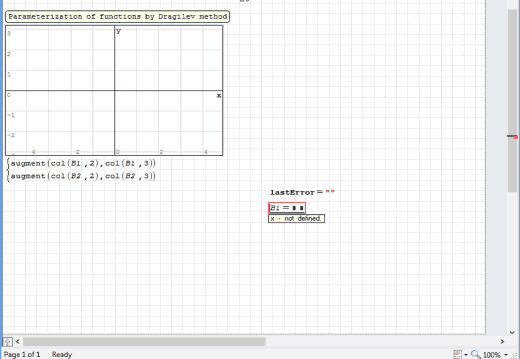

#7 Posted: 2/19/2018 9:28:12 PM
Alvaro Diaz Falconi
Alvaro Diaz Falconi
997 likes in 1676 posts.
Hi Carlos
For see the error message type B1=
#8 Posted: 2/19/2018 11:44:57 PM
CBG
CBG
77 likes in 312 posts.
Hello Alvaro:
Thank you very much.
The error in the graph is that x is not defined.
What causes this error?
In the graphs published by you it is seen that graphs correctly.
Carlos

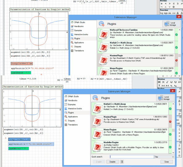

CBG
CBG
By--> Razonar
Quote
Hola Carlos. Try the following, a short version, just for n=2
By--> Ber7
Quote
Try also the old version of the Dragilev method
DragilevMet3.sm (24kb) downloaded 10 time(s)
Hola Alvaro, Hello Ber7,
Thanks for your reply, but the DragilevMet2 and 3 files do not work.
The file of Ber 7 does not show any error, but by requiring the value
of B1 and B2, it says that "x" is not defined.
Attached drawing of the errors.
Hello Jean, your files worked perfectly.
Carlos

#14 Posted: 2/23/2018 3:56:57 PM
CBG
CBG
Hola Alvaro:
Gracias por tu respuesta.
Thanks for your answer, but I found the fault.
The interference is caused by the Maxima Plugin,
by disabling it, the file works correctly.
Carlos
#15 Posted: 2/23/2018 11:30:39 PM
CBG
CBG
Hola Alvaro
Here too, the problem is caused by the decimal separator "Point",
Changing in options, the decimal separator from "Point" to "Comma", (from "." To ",")
resolves the problem of graphing
Carlos
