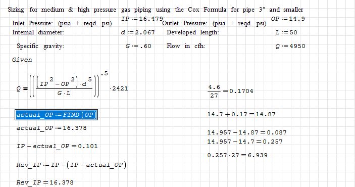

we have been using a very old version of mathcad and while surfing the web I came across Smath and i believe i should be able to perform the same executions with this software.
I tried to open the existing files into Smath but the equation no longer solves.
I believe my issue is finding the corresponding function from Mathcad to Smath.
The Mathcad function I am looking to for in Smath is "Find"
Find = Returns the values of var1, var2, ...., that solve a system of equations in a solve block. returns a scalar if there is only one argument, otherwise returns a vector of answers.

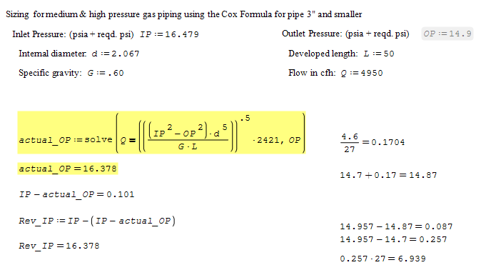

attached is a screenshot of the High pressure formula. i do not believe this is proprietary to mathcad. it is just a formula based on building codes for construction.

we are trying to solve for OP and i have another one where we are trying to solve for PD but if i can manage to figure out how to fix one of them i think i should be able to get the Low pressure to work as well

Your problem seems to be quite simple and mentioned here on the Forum many times (maybe to many...).
Using solve()
GASHP-cor.sm (9 KiB) downloaded 44 time(s).

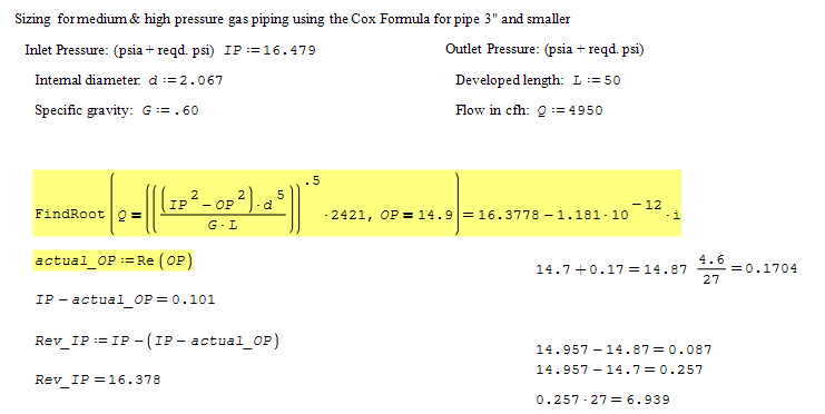

Using FindRoot() from Numerical Solvers plugin
GASHP-cor1.sm (10 KiB) downloaded 57 time(s).
