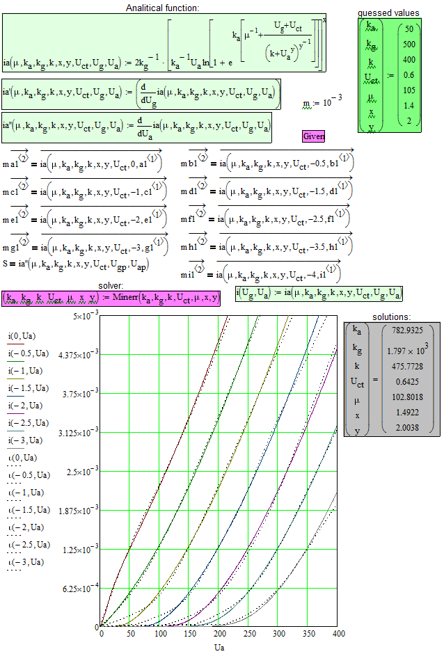

Greetings.
This is an attempt to approximate the physical graphical characteristics determined by the manufacturers of some electronic devices with a family of curves of an analytical function. In Figure 1 I presented a solution in MathCAD using the Given / Find block associated with the Levenberg-Marquardt method. The values of the guessed elements were determined by probing so that the curves of the analytical function (continuous colored lines) overlap as precisely as possible over the curves determined by the measurements (dotted lines). In Attachment 2, I imagined a solution by applying the same Levenberg-Marquardt method. I do not know why I got the error in the picture. Maybe someone could explain to me, or maybe already has a solution to the problem. All the best.
The Mathcad/Mathsoft block Given/Find, Minerr, Minimize, Maximize is a proprietary wrapup
of Numerical Recipes. No such thing is even close in Smath. Further, few of the parameters
in your Mathcad image are from the blue and no data set. Up until now: can't help.
On the other hand, I have 70 Smath work sheets optimizing model function(s) wrt to
data set, based on Conjugate Gradient, iterated manually.
If you are willing, post ONE [only one] data set c/w no parameters from the blue.

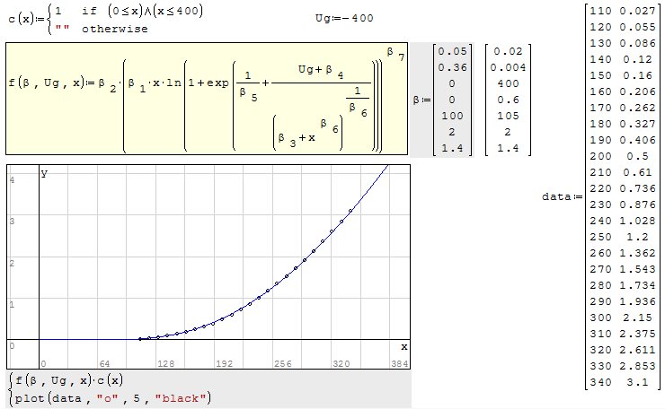

Here is an applicable file. In this case, all variables (μ, ka, kg, k, x, y, Uct) are positive according to the results obtained in MathCAD. The Ug and Ua variables are control parameters. Ug takes values between -4 and 0. Ua takes values between 0 and 300. The sizes I have inadvertently deleted have the values: S = 0.0016, Ugp = -2 and Uap = 250. I apologize for the inconvenience.

... according to the results obtained in MathCAD.
OK ! but you have nothing worth from Mathcad, looking at the plots.
1. Your model function looks to complicated if it would work.
2. Intuitively, it would be Given/Find ... NOT Given/Minerr.
3. ... and the derivative would have nothing to do in there.
Tentatively, I have fitted two data sets.
Don't forget your data sets are from foreign source, thus just "data".
If you just want to fit all data sets, please confirm, give me two days.
I have no idea how each one is headache !
The concept of "bing/bang/auto/done ... " is BS IMHO [In My Humble Opinion].
OlaNicolas.sm (42 KiB) downloaded 98 time(s).

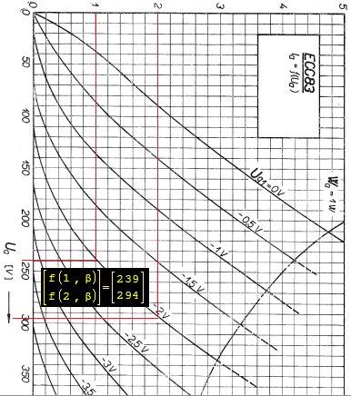

One of the many datasheets of the electronic device in question can be found here: http://www.datasheetspdf.com/pdf-down/E/C/C/ECC83-TESLA.pdf The graphic features I am talking about are on page 12 of the document. The array of data arrays a1, b1, ..., i1 has been sampled by sufficiently accurate methods following those characteristics. My purpose is to determine an applicable set of μ, ka, kg, k, x, y and Uct parameters of the analytical function so as to approximate as accurately as possible those characteristics. I know that SMath may be less than MathCAD, but I would like to find even a less extensive method to achieve approximation. That's why maybe only 5 of the 9 data arrays could be used. Or perhaps even some less epaining methods would be found.

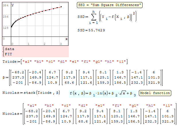

Once the data sets are ordered and stripped from zeros, < 1 min job fit .
Genfit Minimze Nicolas.sm (70 KiB) downloaded 97 time(s).

The data is not reversed. Look better at the original chart. On the abscissa are the anodic voltages, while the anodic currents are on the order. Correspondingly we have tensions in the first column and currents in the second. Now looking at your chart, you will see that it is symmetrical with the first bisector of the axes, that is, the opposite of the original one.
Nick,
Read the other way around: TESLA is walking on the head ... Smath Descartes walk on feet !
TESLA graphs were done by hand [1959], from analog equipment ... just put on graph paper
and done by French Curves. OK well drawn and well digitized. The model function prposed
looks more than valid. From the residuals, you can see the French Curves arcs. This is
obvious because the model function is purely monotonous.
Flip the PC screen up side down to see TESLA graphs.
OBSERVE: the model function is robust wrt Conjugate Gradient, a single set of initials.
Thus, the system could be done recursively for all the data sets [not offered].
Genfit Minimze Nicolas.sm (198 KiB) downloaded 96 time(s). ... refreshed

That's what you have attached. One of many fitting techniques, is data reduction
That's what you have in the recovered from all β's calculated separately.
Your proposed model ln(exp(,)) is not digestible for Conjugate Gradient.
As it looks, neither it is in Mathcad from the crappy fit you showed.
You can have it manually, but nothing any better than the model offered.
The TESLA model in Genfit Minimize Nicolas can be set recursively to collect
all β's at once for the "Recover" page ... this one too can be set recursively.
All in all, Smath can automate quitea few of those Triodes you want to digitize
for the generations.
Page1 Nicolas Formula.sm (42 KiB) downloaded 86 time(s).
Page1 Nicolas TESLA Model Recover.sm (185 KiB) downloaded 94 time(s).
Genfit Minimze Nicolas.sm (203 KiB) downloaded 98 time(s).
