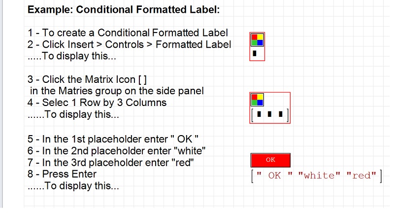

3 - I can't enter the square brackets at the beginning and end of the CFL defining... like...
[" OK " "white" "red"]
The CFL widget only lets me enter parentheses, not square brackets.
Is there a trick?

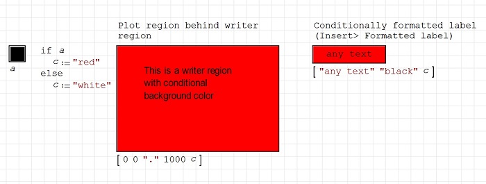

5 - How to add a clickable button to change the color of a Writer Region or a CFL?
(someone shared Background.sm with me that has this example)

Is there a trick?
Use matrix, square brackets are matrix.

5 - How to add a clickable button?
There is Radio Buttons which can be used.

I don't know a way to change color of a Writer region with a button.
You can use CFL for this scenario. CFL's purpose is this actually.
Change its content, foreground and background colors with variables.
And you can use Radio Buttons to alter a variable.
And use that variable value in CFL's if() or cases().

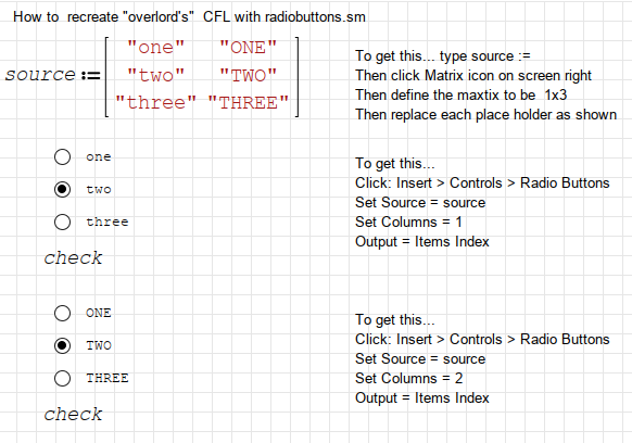

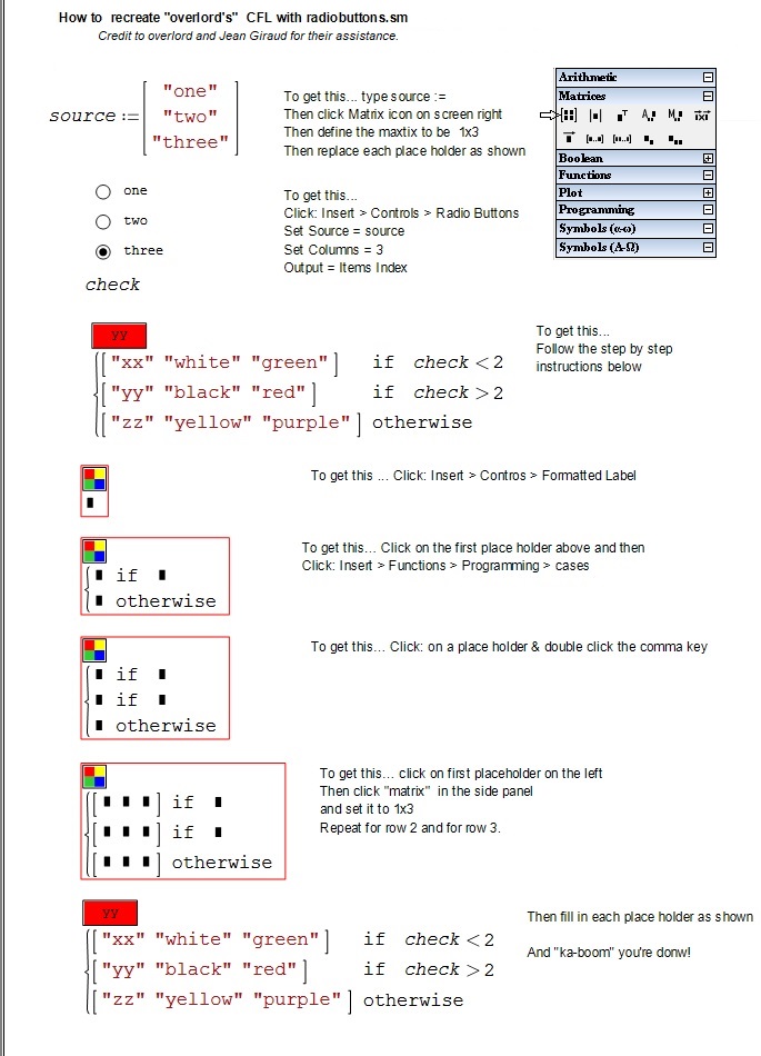

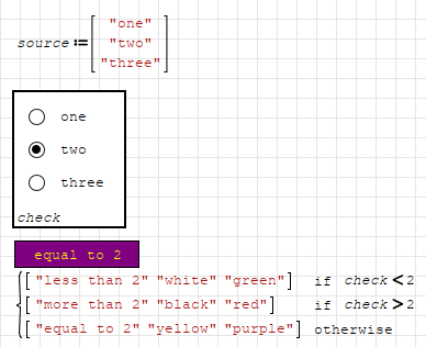

In overlord's post near the beginning of this thread he provided a sample...
CFL_with_radio_buttons.sm
I was trying to replicate it from scratch to see if I could do it...
- I created the 3 radio buttons...
- I created an "expression" with 3 placeholders vertically
- Then made a 1x2 matrix for each of those 3 placeholders
- Then made a 1x3 matrix for the first element in the 1x3 matrix
But it doesn't look the same as his... mine looks like this...
Question 1: How were the 3 lines in the CFL Created?
Question 2: How was the "if" statement created without an "else" ?
Also, when I downloaded and launched his example it told me he was using a newer SMath version
My SMath version is 0.99 (build 7822) Date 6/1/21. on Windows 10 Pro
Question 3: If there is a newer version/build would I install it on top of my existing version or first uninstall the current version of SMath?
Thanks for the help folks !
with cases() function.
With cases() function.
It is useful for multiple if situations.
No need for uninstall.
It will install on top of your SMath.
You settings and plugins shall be preserved.
You will need to uncheck beta exclude.

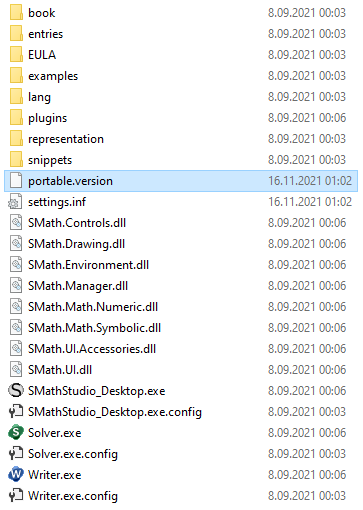

a - You don't need to install beta. You can set smath to act as portable.
All extensions, settings, etc will be kept in that directory.
Just download SMathStudioDesktop.0_99_7921.Mono.tar.gz or any other build.
Extract it to a directory. Create an empty file "portable.version"
That smath will be portable sitting along with your installation.

OK, I downloaded MathStudioDesktop.0_99_7921.Mono.tar.gz and used 7zip to get it all out into a folder a advised.
- I then created a empty file portable.version in the same directory
- I then double clicked SmathStudio_Desktop.exe to launch the program but... suprise...
... SMath Solver opened up. I'm unsure what Solver is unless it is the engine SMath uses to solve equations...

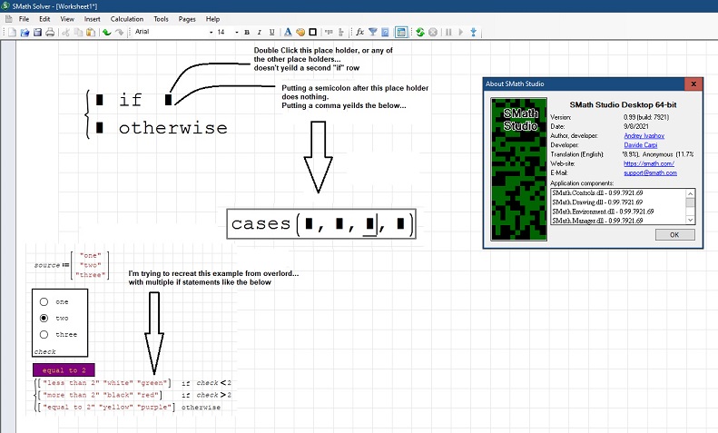

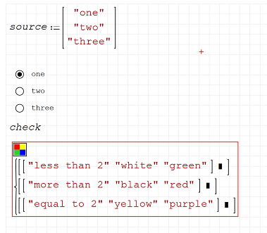

Question 3: Re cases function... used in overloards cfl_with_radiobuttons.sm early in this thread...
- I created a CFL and for the placeholder...
- I created a cases function but it only created one "if" case followed by "otherwise on the next line...
How to create more if cases? (I banged on it and made numerous attempts and scanned the custom functions thread... but no joy.)
Thanks
#13 Posted: 11/15/2021 11:08:04 PM
983 likes in 6866 posts.
1. Get the basic if/otherwise [Cases]
2. Click on the the RHS place holder
3. Enter twice
#14 Posted: 11/16/2021 1:14:48 AM

Question 1: Is it the latest SMath version?
It is latest.
Now we have Solver and Writer.
Solver is traditional smath interface.
Writer has more like Ms Word style.
Question 2: where is that checkbox located?
Click local storage in plugin window, there you will see it.
Question 3: How to create more if cases?
Use arguments separator. "," or ";" which of you had set.

#16 Posted: 11/16/2021 1:56:39 PM
Question 1: I must be misinterpreting your instructions... can you advise?
On that place holder top right ... double click coma keyboard
Try it ... Cheers ... Jean.

Hit comma again, a new ifline shall be added to cases.
My argument separator is semicolon, so don't be confused.
According to your screenshot, yours is comma.
cases()
Question 2: must I delete the plugin and re-download/install it?
Not need to delete.
Plugins shall be automatic updated.
#18 Posted: 11/16/2021 7:03:43 PM
Fran Lee
Fran Lee
1 likes in 44 posts.
Da Da!
(Credit to overlord and Jean Giraud for guiding me along the way.)
CFL_RadioButtons_Step_by_Step.sm (13 KiB) downloaded 92 time(s).
Hopefully this step-by-step will help other newbies.
PS Let me know if I made an error... but it looks to me like it's working.

#20 Posted: 11/16/2021 9:45:13 PM
555 likes in 1333 posts.
This is not an error but it needs a clarification.
Setting column in radiobutton shall tell region which column shall be used for source.
In screenshot below you can see there are two columns of data.
If you set nothing or a nonexisting column, it will take first column.
If you set an existing column, it will use that particular column of the matrix.
