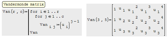

is there an inline-variant of the loop mentioned in the picture,
loop
because when i try to add an index to the function w(x) it throws a syntax error.

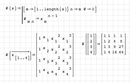

Hi Crang. This could be an option
VandermondeMatrix.sm (6 KiB) downloaded 66 time(s).
Make it algo style for infinite local use.
Cheers ... Jean.
#4 Posted: 5/25/2022 7:38:47 PM
983 likes in 6866 posts.
... make Vandermonde algo style for any local symbolic/numeric
