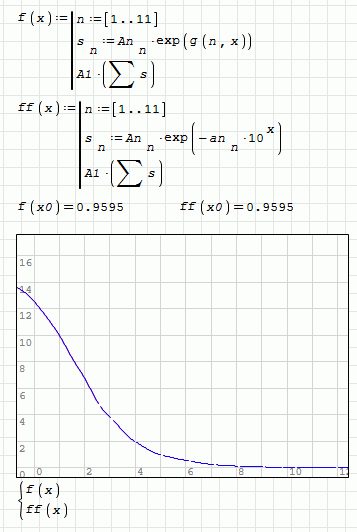

Hi. Summatorie ranged have some issues. For instance, the range variable isn't local. With eval you can get punctual results, but this version can't be plotted, and I don't know why:
Whith this other version you can do both things:
Hope that this helps.

... more doctoring in the *.sm attached
1. local definition mode
2. index piece wise
exponential_max_err_v0 (1).sm (24 KiB) downloaded 42 time(s).

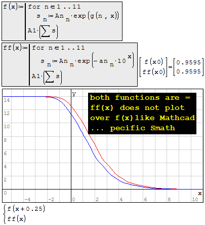

... code this to the previous doctored document.
Summation operator is very capricious, but works
and plot scalar as demonstrated. Plot scalar for
lot more involved stuff [Budapest 39, Legendere ...]

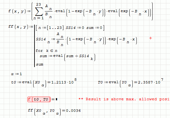

Here are another sample file.
exponential_max_err_v03.sm (18 KiB) downloaded 40 time(s).

Hi. Yes, it's hard to drive those calculations. Try to avoid sum(1) too:
MSL 8/13/2019 11:09:00 AM

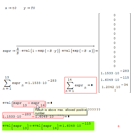

I think something is wrong here in the numeric/symbolic engine of SMath which causes those errors.
Version "0.99.7109"

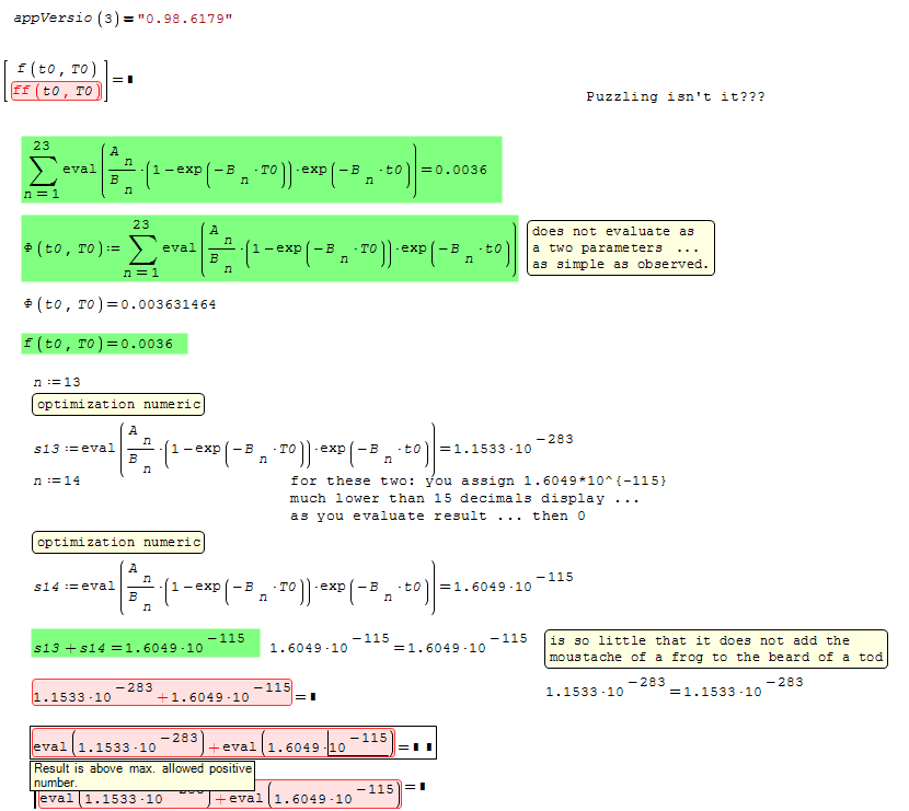

I can not understand this . The error message is quite confusing. The result is quite a small number close to zero. On the other hand, by mouse hoovering the vector it could be seen the fraction presentation of the numbers (symbolic engine) with quite large numbers in the denominator. Therefore the message about max. allowed positive numbers. I think something is wrong in the floating point arithmetic in SMath numerical engine or at least quite problematic. It seems that eval() must be used extensively in order to escape from these traps and to avoid the symbolic engine to make a mess here.

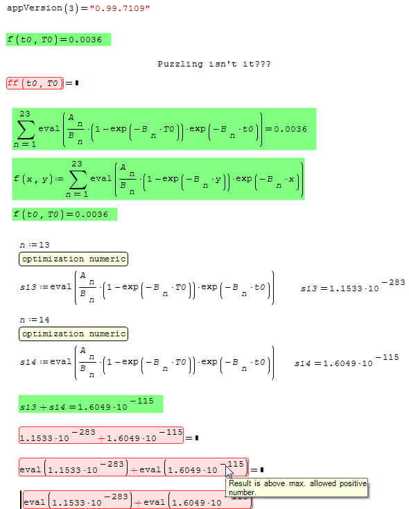

Version "0.99.7109"
From observation in many more SS 7109, the indexing is freaked.
Doctored in pink SS 6179.
exponential_max_err_v03.sm (17 KiB) downloaded 44 time(s).

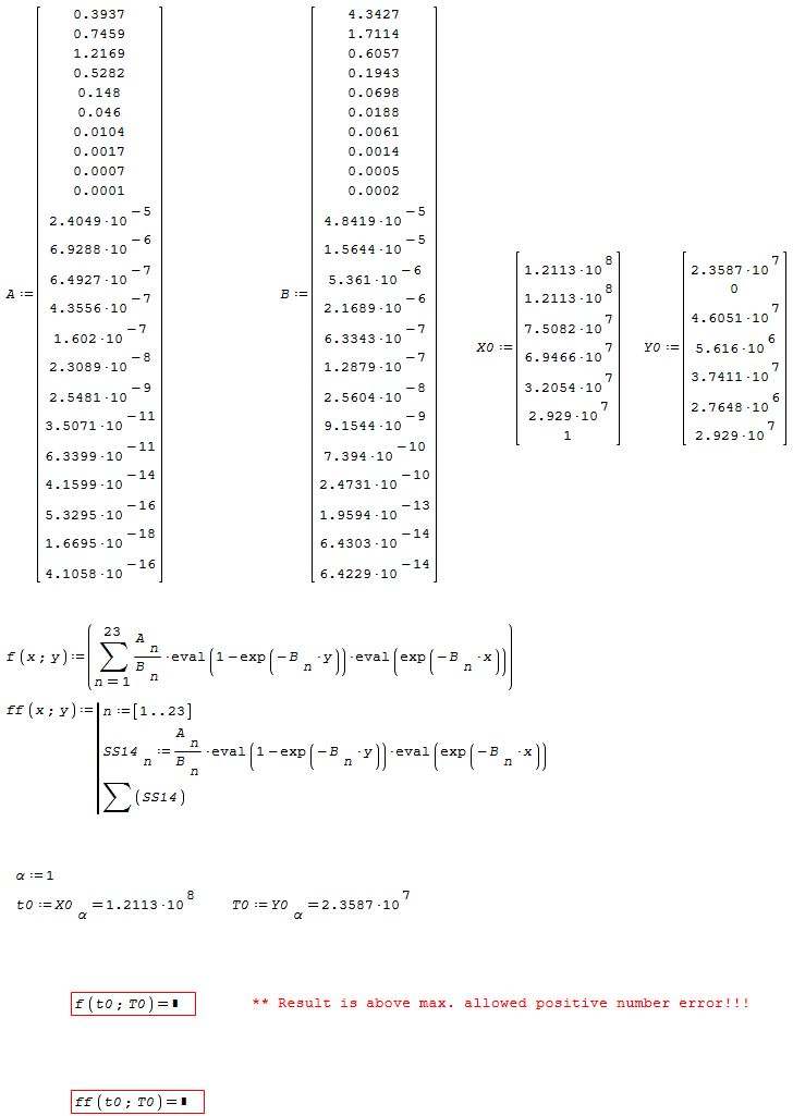

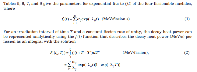

Dear jean,
I'm just doing the calculation of an ANS standard example.
I think this problem is a kind of overflow of exponential function.
As you know if X is greater than the 709.783 then the value of exp(X) is overflown.
So I believe that SMath should do something to check the nominal boundaries of special functions (exponential, logarithmic etc.)
Thank you!
regards,
MS
Version "0.99.7109"
Still confused...
exponential_max_err_v03-corr.sm (31 KiB) downloaded 41 time(s).

That mystic formula has to be put in executable maths
exponential_max_err_v03-corr [Next-Suite].sm (160 KiB) downloaded 41 time(s).
#18 Posted: 8/14/2019 1:17:41 AM
983 likes in 6866 posts.
Please, check my interpretation.
exponential_max_err_v03-corr [Next-Suite].sm (185 KiB) downloaded 37 time(s).
#19 Posted: 8/14/2019 3:20:01 AM
325 likes in 2052 posts.
Still confused...
Doctored a bit SS 6179 ... No red in No time.
exponential_max_err_v03-corr.sm (32 KiB) downloaded 46 time(s).
Still red for me...
