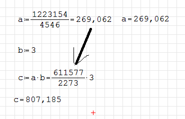

Hi everybody!
I'm beginner in Smath. I met a problem when use explicit function. I can't show values of variable in decimal format (in case it's irrational number).
In my example, please tell me How to show value of a in decimal format in expression of c. Thanks

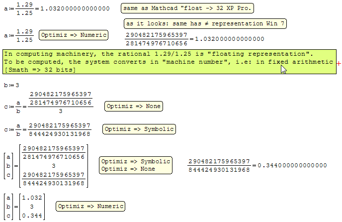

#3 Posted: 12/16/2017 12:29:21 PM
983 likes in 6866 posts.
Maybe just click right for the "Numeric option"
If you define a:=1, b:=2, c:=3, d:=pi
MyStuff:=a*b*c*d ... what is the point to display
MysStuff=1*2*3*3.14159=
manhtruong 12/17/2017 2:33:00 PM

#6 Posted: 12/17/2017 2:32:22 PM
manhtruong
manhtruong
0 likes in 5 posts.
I followed your instructions. But the problem remains unresolved. Do you have any other way?
#7 Posted: 12/17/2017 10:28:01 PM
A Snippet + Work sheet to check consistency in you PC.
To get all the trailing 0' => set decimals 15 [first]
then set "Trailing 0's => 15.
If you visit Abramowitz & Stegun, you will find lot of
approximations are in fixed arithmetic rational fractions.
Does it help ?

#8 Posted: 12/18/2017 7:59:53 AM
manhtruong
manhtruong
0 likes in 5 posts.
Very helpful, thank you very much!
