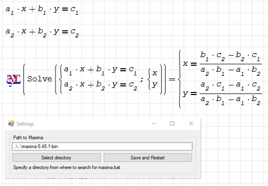

Such as this
a.1*x+b.1*y≡c.1
a.2*x+b.2*y≡c.2
How to get symbolic results for x and y

Hi, It's posible whith Maxima Plugin

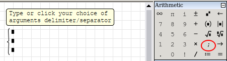

How to input more than 2 equations in Solve after curly brace?
There are only 2 placeholders by default.

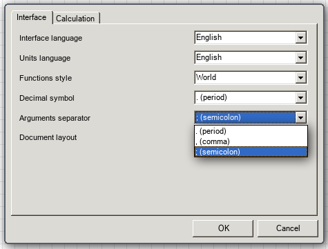

#9 Posted: 2/13/2022 11:27:27 AM
555 likes in 1333 posts.
This includes expanding vectors, adding new arguments to functions, etc.
