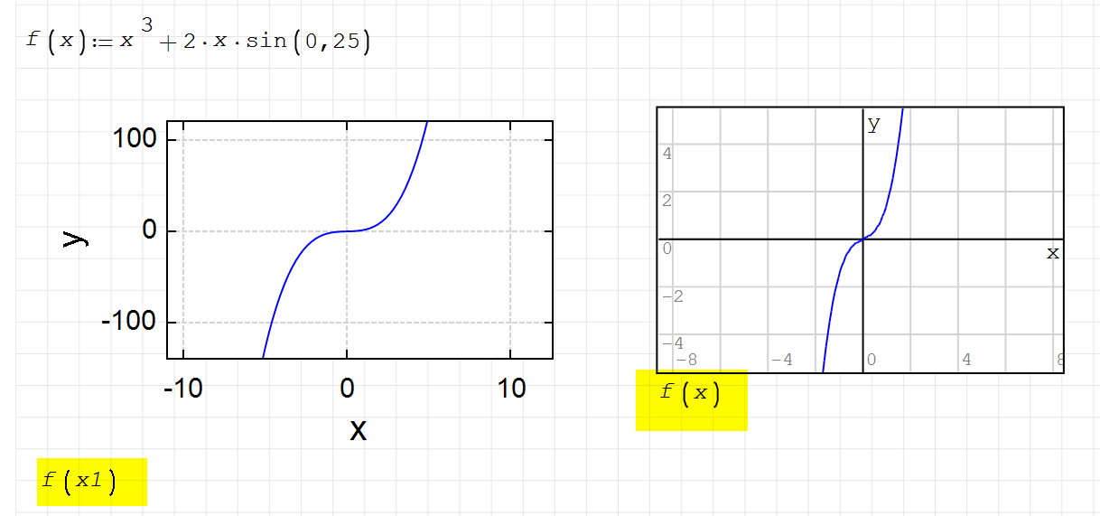

You have defined a vector of values ​​for x. If you use the X-YPLOT plugin you need to change the variable. If instead you use SM native 2D graph then it already works as you expect

Hi, if you need a quick plot I recommend you use 2D standard plot you can plot functions f(x) directly , if you need a more configurable plot use XY plot but you need to put your data in a special format. File not found.File not found.

You don't need to use range() and augment() if you want to plot sections.
You can limit it with if-else() or cases().

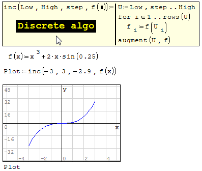

Equation 1 - Normal distribution does not solve as a function until it is vectorized. Why?
1. Discretize the range you want and plot ... No vectorize.
2. Plot scalar directly.

... in most applications inc(Low,High,step,f(#)) is preferred
Paecific.sm (14 KiB) downloaded 71 time(s).

Scalar plots have limited use, mostly confirm the project.
Discrete plot can be used for subsequent application/export.
1. Collapsed the algo at top utilities.
2. Use it infinitely in-situ use [range each f(x) at will].
