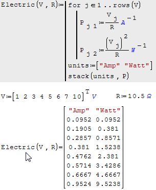

Hi all,
This is my first post in here.
I was wondering whether it is possible to change the unit of a matrix element within a for loop.
Here is a small example:
Example
I would like to change for example the Current and Power unity to mA and mW respectively.
Thanks in advance
#2 Posted: 6/10/2022 11:51:27 AM
115 likes in 329 posts.
Watch this discussion (Razonar provided good suggestions)
https://en.smath.com/forum/yaf_postst18903_Units-not-simplified-in-Matrices.aspx
#3 Posted: 6/10/2022 6:44:50 PM
555 likes in 1333 posts.
Subjectively better looking version for Razonar's example.
Not very practical though, need to re-write for every new units.
I think this should be a feature, using a matrix units for matrix output.
This is how I wrote a pseudo 'matrix looking like' variable.
'\005B\ohm\0020\mA\0020\μV\005D\
Rest is copy paste to place holders.
matrixunits.sm (3 KiB) downloaded 74 time(s).

#4 Posted: 6/11/2022 4:18:53 AM
1230 likes in 2155 posts.
Very smart use of multiplicative split of result display!
#5 Posted: 6/11/2022 7:55:17 AM
I don't know if example below is posted before.
You can create multiline named variables too.
Same logic with post I wrote matrixed units.
Copy text below and paste into smath.
This\0020\is\0020\a\000A\multiline\000A\variable:10^3

#6 Posted: 6/11/2022 9:34:30 AM
983 likes in 6866 posts.
You can make it algo style for in-situ command line.
