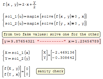

#1 Posted: 10/30/2018 12:57:17 PM
zapzapouch

Hi. Something like this?
or
AfromB_or_BfromA.sm (13 KiB) downloaded 76 time(s).

#3 Posted: 10/30/2018 7:39:06 PM
983 likes in 6866 posts.
It's possible to make two converters,
Maybe like this as demo.
If you have an equation of one variable and several parameters,
the solution would be much different, still via maple(root0.
