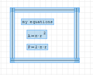

#2 Posted: 3/24/2016 9:17:22 AM
983 likes in 6866 posts.
You can group poroject parameters, anotate ... simply.
Highlight as you wish, click to border. All the parameters
in this example are active for the next project procedure.
For that special bracket: click in palette at right to get
the first pair, click on the lower place holder, press
coma, coma, coma ... to add more. Put more instructions
in a separate text box. Will that do ?

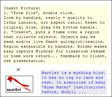

#5 Posted: 3/24/2016 11:01:50 AM
Thanks,
This is a rather nice possibility I haven't thought.
Would it be difficult to make a plugin for a drag-to-resize box?
This would give even more freedom.
Don't need a plugin, use the Insert => Picture => Create.
It plugs a box with handles ... stretche each direction.
To view the bounding box: click on the square in the menu,
slide over your collected stuff: text, image, equations ...
Click anywhere in that creation, the inside stuff disappears,
stretche with the handles, click away outside, bingo the
all creation is back.

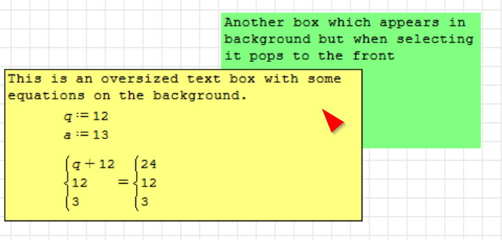

#9 Posted: 1/28/2018 6:30:14 PM
Jaan Praks
Jaan Praks
1 likes in 9 posts.
A question about order of objects on the canvas.
It seems that objects earlier in execution pipe (upper on the sheet) are selected first, but displayed on the background. Therefore if there exist overlapping objects, I cannot select the object which I see in the front.
The figure explains. If the boxes are arranged like in the picture and if I click with mouse the area marked with arrow, I select green box, which appears to be on the background. Why?
Wouldn't it be logical with other way round? Other way round would allow to create also bounding boxes with ease.

#13 Posted: 1/29/2018 3:49:25 PM
Jaan Praks
Jaan Praks
1 likes in 9 posts.
My question is: when clicking the red triangle on the sheet (picture below), why green box on the back is activated, not yellow? Why clicking things which appear on the front, activates things which appear to be in the back.
It would be more logical when clicking things you see, they get activated.
For example, the equations in the yellow box are behind the box. One can see them, which is nice feature, but one cannot edit them (unless you drag the yellow box away).
It would be very handy and easy to play with bounding boxes if the equations "in" the box would be on top both visually, and also for selecting with mouse.
#14 Posted: 1/29/2018 4:00:22 PM
1230 likes in 2155 posts.
I don't know the design intent. Just want to mention that you don't need to drag away the background box. Exploit the fact that you can move the region focus using the keyboard. Just click one region and press TAB or Shift TAB or Arrow up and down. A region with focus is in the foreground and you can move it with the mouse (drag the border) or edit it's contents.
This is usually more convenient than to temporarily remove the covering region.

#16 Posted: 1/29/2018 5:30:58 PM
Jaan Praks
Jaan Praks
1 likes in 9 posts.
Quote
Thanks! The TAB trick is handy. I did not knew this (or forgot about it). It helps. However, it would be even easier it the focus would go automatically to the object displayed in the front. The focus order could follow the reverse execution order, it would be also logical.
