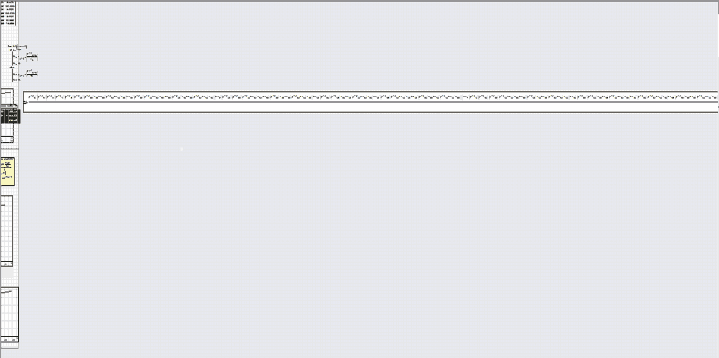

When you put in Smath Studio the pointer over an operation, as in this case
of the Thiele function, you get the following visualization of the result.
When Smath Studio is requested to present the result, it is shown as follows:
Here the question is: if Smath Studio has 2 forms of presentation,
which I call implicit and explicit. Why not explicitly have also the first (the Implicit),
which in this particular case, I consider, which is a better visualization of the function?

#2 Posted: 5/2/2018 7:49:16 PM
Try using "none" instead of "symbolic" optimization

WroteHere the question is: if Smath Studio has 2 forms of presentation,
Works gorgeous Smath 6179 ... top to bottom.
Lovely bonus => expands the reduced J_Frac form !
I have not recollected the export [RemToDo].
Gracias Carlos for that magic compactor.
